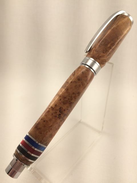

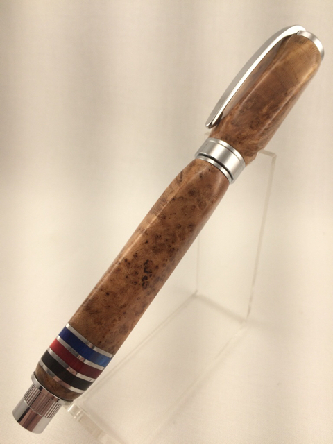

I just finished this cherry burl using the CA technique above. This has a twist in the body, so I can't run the lathe to apply the CA. Finishing this type of pen is how I discovered you don't need to run the lathe to apply CA. The picture does not do the pen justice, the finish is super clear, smooth, and glossy. The other lesson I learned, use teflon cone bushings, don't use the pen bushings.
