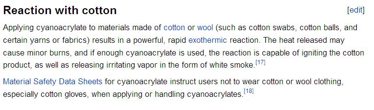

Here's a little fuel for the CA fire. This is from Wikipedia. I'm surprised that I'm not a pile of ashes. Somedays I get more CA on the shirt than I do the project.

OMG, does t-shirt qualify as cotton? does spilling the entire bottle count as enough CA? you are right, its a wonder i havnt exploded!!

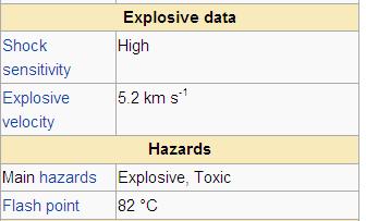

If you're going to say "explode", say it quietly. This is part of the Wikipedia about MEKP, the drops of hardener. While trying to find a way to add color to CA, I added a few drops of MEKP. For some reason it worked.
