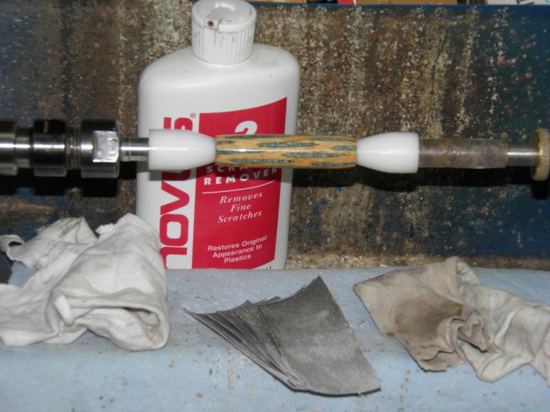

JohnnyCNC makes delrin bushings that you can use for finishing pens. He has them has a set and they work great. Easy to use and the CA doesn't stick to them. Check out this link Penturners Products!
I use them a lot.
This is the method I use. BUT I make my own bushings very simple. Start with a piece say 1" long of plastic Delrin preferably 3/4 round. Drill a 1/4" or "D" hole though it. Put it on you mandrel turn it to a cone like a center. Make 2 of them now you got finishing bushings that will fit any size pen tube. And CA dose not stick well to delrin after doing your finish just take the point of your skew and very carefully score/cut close to your tube to break away or you could chip your finish. Then the extra CA will scrape off your bushing real easy with your skew.
This is the only photo I could find on hand that shows them. Should you get an idea. Taper the point rite down to your mandrel.
This photo that Bruce posted is the way to go. I bought the set from Penturners Products which is a three piece set used to finish both upper and lower at the same time. Before using this setup I had nothing but problems. After trying this system I've had zero problems.
