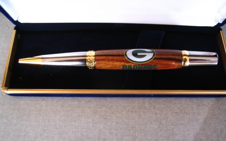

I have done this type with and have had no problems.
Multiple coats of CA on blank and then MM to a shine and then you apply the Tattoo and apply a couple of quick wipes of CA and finish with CA and MM to 12000. The CA polished under the decal hides the edges.
This does increase the diameter of the blank because the Tattoo is 3 to 4 thousandths thick and you have to apply enough CA to cover the edges so you won't feel the Tattoo.
Dry rub Tattoos are much thinner and are covered with much less CA.
The tattoos you wet and put on are also thin but do not have the sharp details of the first above.
