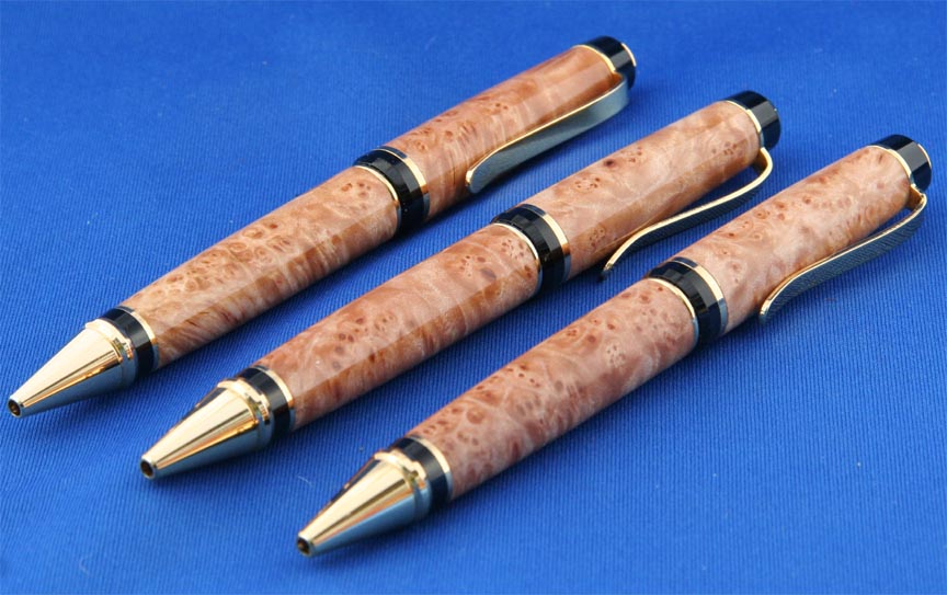

If you do not want your CA to be too shiny, use 3600 to 4000 MM to knock the shine off.
IF the CA is not finished well enough to have a shine, it will be noticed by buyers and by the general public. For me as a test, a few years ago, I made three pens identical and knocked the shine off just for those who do not like shine. In the photos it was hard to tell that it had any CA at all on it. For those who want wood feel but good protection, that was one way to do it. But most people who want a flat finish prefer the wood only. According to about 90 - 95% of those who do sales to the general public, the general public likes the "shiny" ones.
Shiny versus Flat finish:
http://www.penturners.org/photos/images/940/1_3Cigs_3Fin_1burl.jpg
