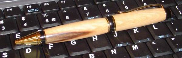

Success! Thank you all for your help and suggestions. I gave up on the cocobolo -- it has so much CA on it it'll take a while to dry, and then I'll sort it out and fix it up. In the meantime I did this Madrone (arbutus) pen. Has a fungus mark, which I think was the active ingredient in the death of the tree.
Thanks again,
Caleb

Looks like a very nice finish, adn I like the looks of the pen as well. Glad you finally got going with the CA Finish. I use it on nearly everyth pen I make, excluding acrylics.
