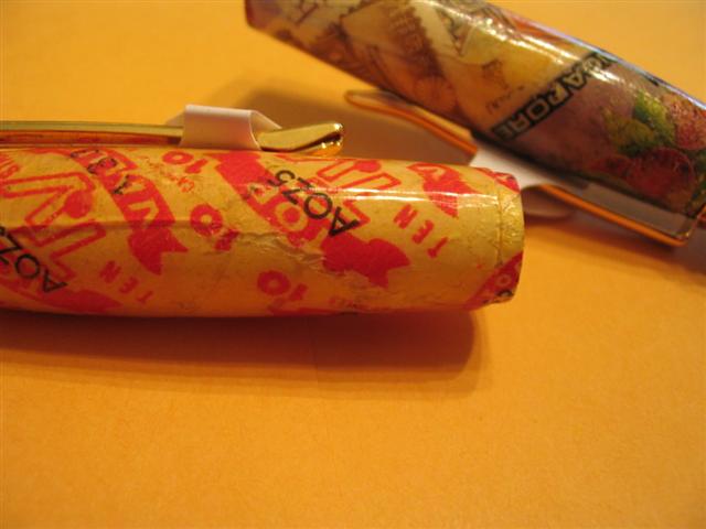

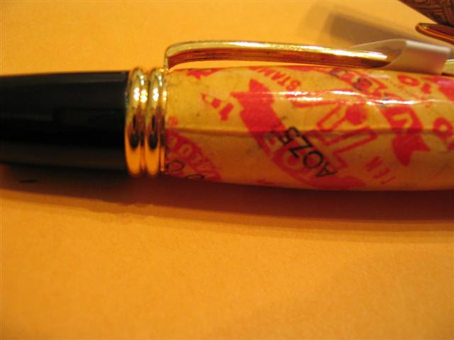

abount nine months ago i made several stamp pens. i turned wood (pine) slightly undersize then glued the stamps on and covered with two coats of modge podge. they they were lightly sanded and finished with about twenty coats of thin ca. while setting up fo a show this past weekend i noticed cracks in two of the pens. a closer look revealed that the finish not only cracked but shrunk by about 1/16" on one end and about 1/8" on the other. i have no clue as to why.

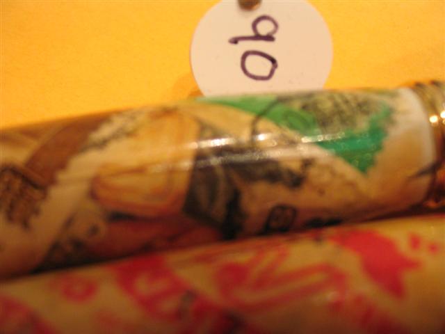

in the first picture the extreme left side has shrunk about 1/16", in the second picture the right side has shrunk about 1/8". the crack goes about 2/3 of the lenght. the pen in the rear of the photos has identicle shrinkage and crack except that the crack is now open about 1/8" all the way to the stamps. the pine under the stamps is construction grade 1 by scraps. the pens are stored with about 200 others with various finishes including ca and are stored where there are no extreme temp changes. the wood is still even with the end of the tube. if the wood had expanded enough to crack the plastic/ca finish i suspect it would have tore the paper of the stamps which it did not. i am totally clueless as to what happened here. the last picture shows the open crack.

what appears to be the wrinkle is just reflection of light. the finish is no longer smooth though. i think any future stamp pens will be cast in resin with the stamps glued to the tube.
