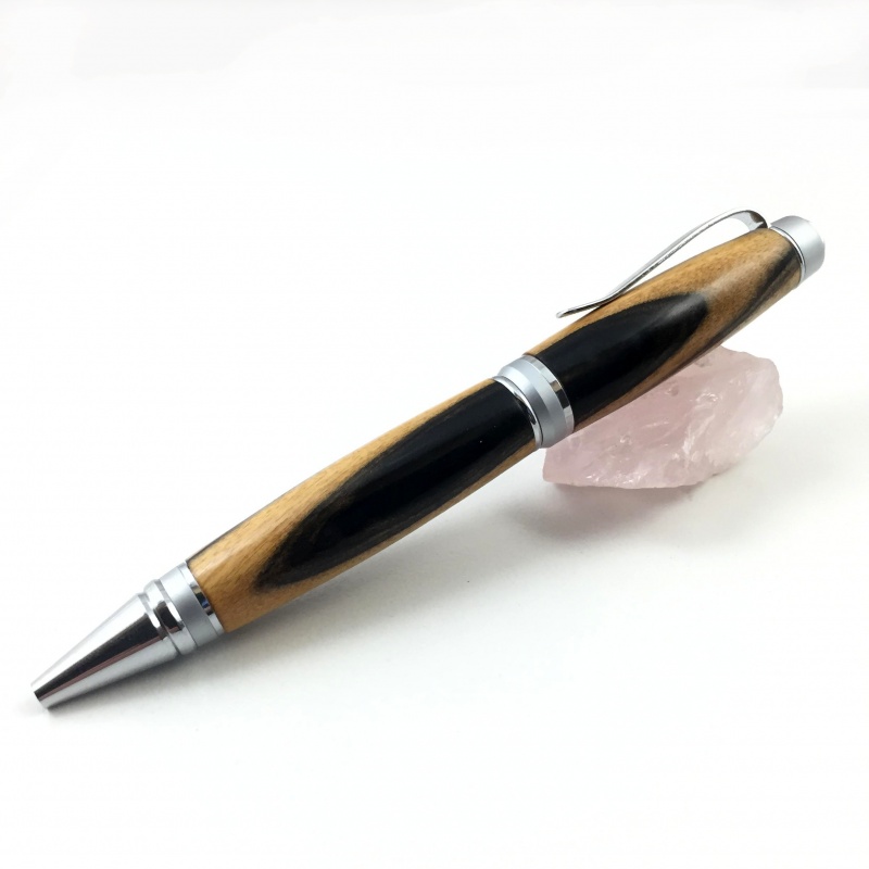

I know this may seem like a basic question, but I've heard people with opposing views on this matter. Does the % of moisture in a wood pen blank matter if it is to be sealed and finished with CA? And will it ever move or crack since it is cut off from the humidity of whatever room it's being kept?
Also, if the ca finish was applied with the normal bushings, that would leave the end grain not fully sealed...What do you think? Is this even an issue?

Thanks a lot for the info! That was my original thought also but wanted some other opinions. I guess I've convinced myself to keep this one as an experiment...I really like it anyways (pic included).
I'll come back and update if it cracks!!:angry:
