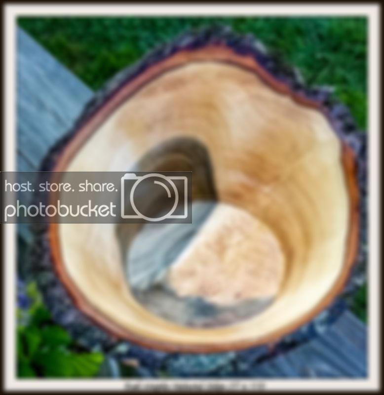

If you're wanting to turn bowls....why buy?
I'm betting you can find a county crew dropping trees on the right of way....like I do.
I'm betting if you approach them 'nicely', and tell them what you need, they will probably cut you some pieces to size(I would). Don't get a LOT of them, unless you can seal them yourself.
Exotic timbers are nice, but the bread-n-butter of bowl turning has to be local timber, and for the price of 'generally free', can't be beat.
Examples are always better then a bunch of words....
This came from a road side.

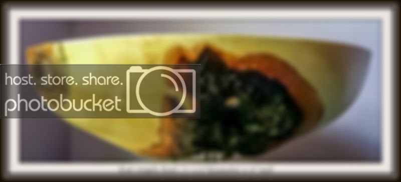

The other half of the same piece.
