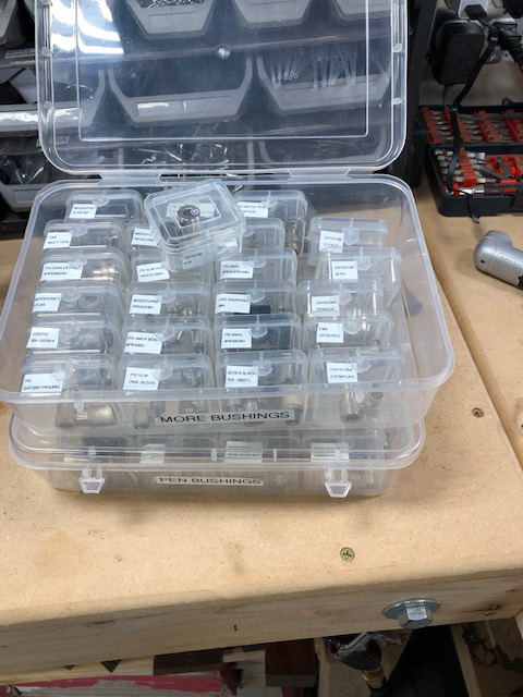

I get a bead storage box from our local Walmart to store my bushings in. It is a clear plastic box with 12 individual round plastic jars inside. I pop a label on the side and top of each jar to identify which pen kit they go with. (They are just big enough to store 2 sets of bushings in each jar which is perfect for me because I always keep my "active" bushings in a jar along with a new set still in the baggie they came in. That way I have a pristine reference set and a backup for when I decide it is time to trash my active bushings and order replacements. - Dave
I love this idea. I am half crazy about wanting things organized. I hate it when I can't find something or have to open a bunch of boxes/drawers/containers to find what I am looking for. Label happy also.

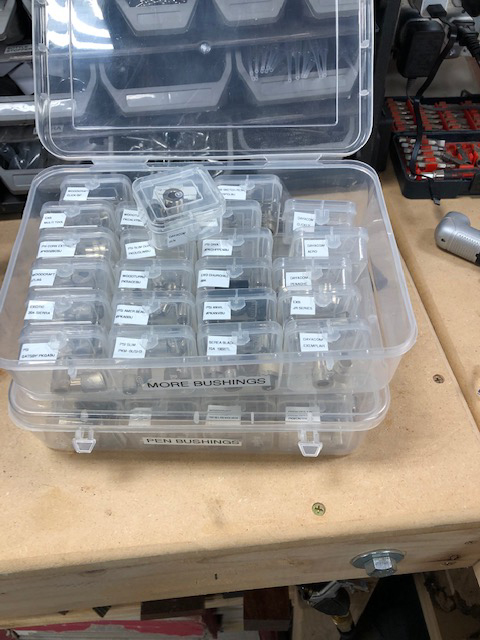

This is not my idea. I found it on here a couple of years ago. These have been working well for me from harbor freight.

Brilliant idea for bushing storage ..... if you MUST use bushings ( I do realize they are good in the beginning ) ....
But, I estimate that you have over $250 worth of bushings .... at least .... in those two large plastic boxes ....

Yes. This was an early stage "learning experience," and I have since moved on to TBC, but I still use bushings on an adapter as a guide to get close before I remove them on unfamiliar kits. This was also a stage when I would buy every pen kit I came across to try. Now I have learned what kits I like to use and have been getting enough experience with them to TBC without the bushings. It all comes down to comfort and the learning process.
If you really want to get a laugh at a wasted "learning" expense, you should see my collection of Whiteside pen mill shafts that I bought for each drill bit size. :rolleyes:
My biggest learning curve moment was paying more attention to the IAP than the guys at my Woodcraft store.

@hooked
I am NOT KNOCKING this .... please don't get me wrong ....
But .... since I stopped using bushings completely, I have been much happier with the resulting pens.
I use digital calipers, measure frequently as I approach the correct diameter, and turn down to diam. of about 0.006" larger than mating pen parts.
NOT KNOCKING using bushings if you feel you have to .... just stating what works for me. . Hope you understand where I'm coming from.
I use a DEAD Center in the head-stock and a LIVE Center in the tail-stock. . . Blank firmly held in-between . . . No bushings and no mandrel.
I like to use the bushings to get me close but no cigar, then finish TBC, That precludes my inherent laziness for using the calipers often enough from having dozens of &**%$&ing over turns...
