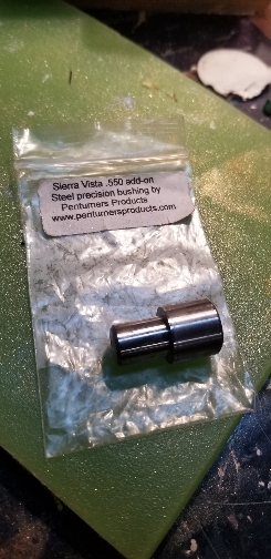

This is for some of the turners that have been around awhile... or if you're new and know don't hesitate to set me straight.
In the process of getting my stuff up and running again I've ran across a bushing that's not ringing a bell with me. The bag was labeled Sierra Vista .550 add on. I'm thinking it came from Johnnycnc. It's larger than either if my other Sierra Vista bushings... and way bigger than my regular Sierra bushings. Any ideas?

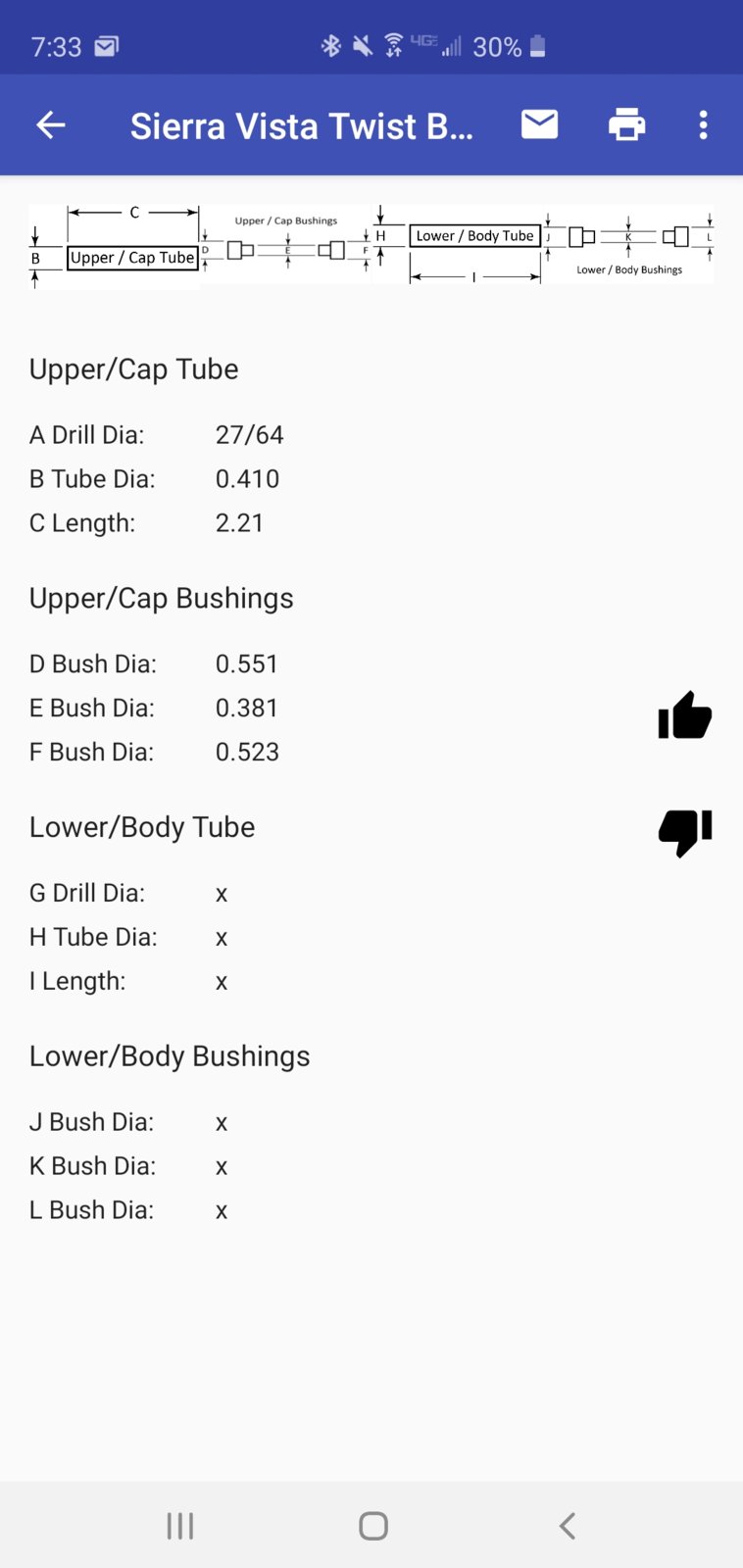

Not sure where you are getting those numbers but I know for fact and only because I am working with them right now that the Sierra Vista has a 13.96 and 13.24 bushing. This is for Bearra Hard woods, Beartooth woods,and exotic vistas.
You are showing a two piece pen with cap and barrel. Any Sierra that I know of is one piece.
To the OP are both bushings the same or is one smaller than the other as is the case with all sierra vistas. Or is there more than 2 bushings?? We need more help. Johnny use to make between center bushings that had cone ends.
OK Dummy me, that is in inches and the measurements I gave are in mm. That .550 is the dimensions for the cap portion of the Sierra Vista pen kit. The nib bushing is slightly smaller. It is probably longer because that is the way he made them. But diameter is correct. Maybe you have been using the wrong bushings all this time. You said you have been away for awhile.

JT this is the package it was in

Yep those are probably turn between center bushings. See if the end has a cone hole and sometimes never went all the way through.
Sorry I should have made that clear in the first post. Yes it TBC. The other Sierra vista bushings that I got from Johnny are labeled CUSTOM size. I can't remember the reasoning but there was some reason he made them at the time bur that's was probably 5yrs ago.

The reason it was a 2 piece picture is due to how the IAP bushing app shows it. That was a direct screen shot of the app
