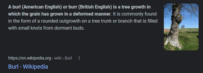

I was trying to find what you call the growth over a damaged part of the tree and this came up in the search. Like Bono, however, I still haven't found what I'm looking for.
EDIT: I also found this, and found it interesting

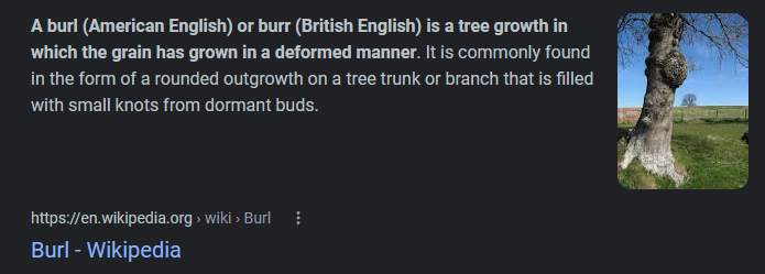

Nice. 😆 🤣
I bet this came from The Joshua Tree. 🙂
