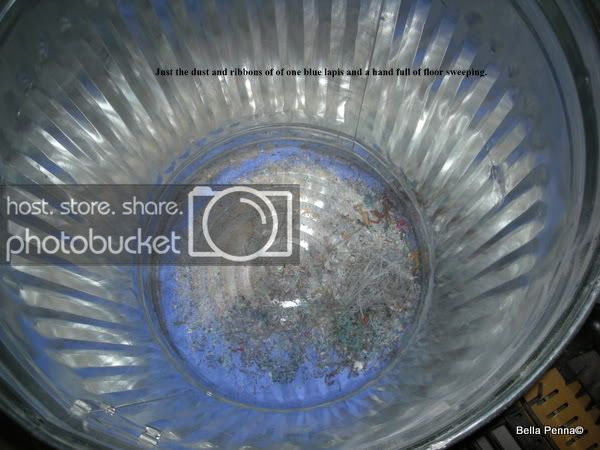

Two weeks ago I had posted that it was time for me to do something about my dust collecting system. I do mostly acrylics and after doing two-three pens the strings would clog up the impeller on the dust collector. So the system became useless, by the time I got around to sanding. I just got tired of really not using it for it's intended purpose...keeping the shop as dust free and ribbon free (acrylic,Lucite,etc. ribbons) as possible.
So the last few days was spent making a Thien separator, can't belive how well it works with out the Wynn filter that I ordered today so it should even be better. Cost in material was around $60 including a new trash can.

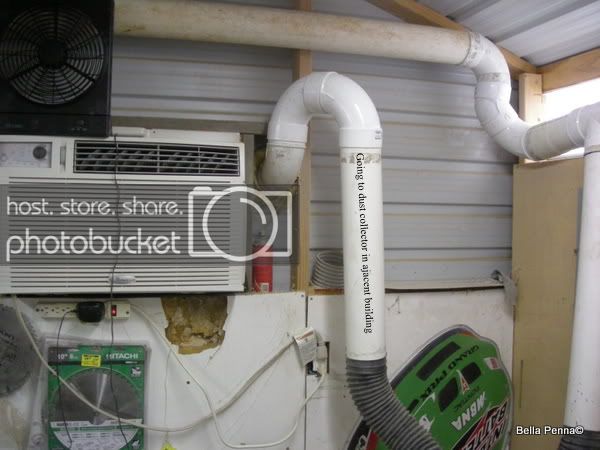

1) I think you mentioned in the other thread that your DC it outside your shop space. It's sucking the Air out of your shop, but how is the air coming back in? Do you have a return from that space back into the shop?

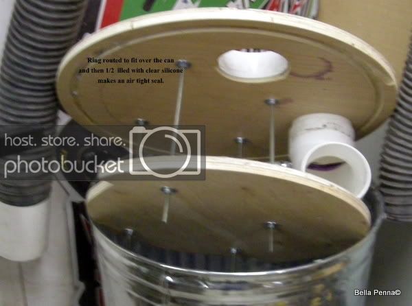

Can you share a picture of the guts (ie just under the lid)? I've seen some on web sites - curious if you did anything different?
No need to aqs during spring and fall always leave the door open:biggrin: and in the winter with butane heat the door is cracked and being a metal building is not air tight.
Pictures just for you:wink:

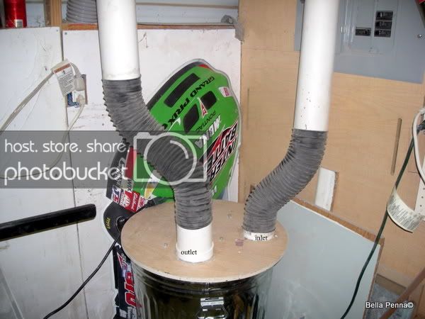

First of all: I am in no way questioning any of your work-just trying to be clear so that I can move my DC outside and I am glad that I can use the excuse that I am blonde because I am confused. What you have marked as outlet on the garbage can is actually the suction from the dust collector, right? I am curious because if a chunk of wood comes in wouldn't it be held up on the inside piece of wood and go to the suction and into the impeller? I may listening to many peoples warning about chunks and damaging impellers. Now Jet came out with their version of a Vortex this is getting interesting. I looked inside the Jet vortex dc today and all they did was to add a chinese looking hat above the collector bag. Very nice looking setup Roy. Wasn't there a tutorial somewhere about your particular setup? I need to add the inside piece of wood because mine does not do all that well. Thanks.

Mike, yes that is the suction and the design of the lower piece is such as to create a vortex so the smaller particles like dust would fall into the can via the opening., larger pieces drop threw because of their weight. A piece that is large enough to not fit into the opening is highly unlikely ever to get that far and if it did and the suction was strong enough to get it all the way to the impeller there's a wire mesh guard in front to protect it (that's where all my ribbons of acrylic would clog the suction.) Hope this answers your questions
OOPS, forgot here are the plans I used:http://www.cgallery.com/smf/index.php?topic=137.0
