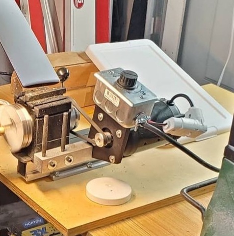

Hi all
I'm looking to build sanding and polishing station similar to the one in this picture made by Sean at the London Pen Company but I haven't been able to find information on where I could get the parts to make it appreciate any help thank you

A sewing machine motor, about $25 on eBay, a motor shaft arbor adapter, also on eBay, about $25, A drill chuck to fit the adapter arbor about $10, also on eBay. You can use the foot pedal speed controller, but I would suggest using a router speed controller from Harbor Freight, I think they are about $20 or $39.
If you have a Foredom, you can create one using a handpiece that holds a 1/4" shaft. You would need the above shaft adapter and the drill chuck.

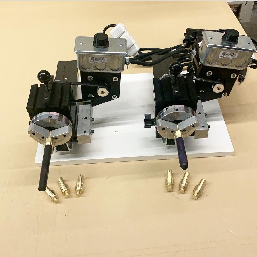

Do you have any other photos of these machines? I know they are both Taig headstocks, ways and chucks, but the motor and mounts have me baffled. They could be the same or a variation of the universal sewing machine motor I mentioned in the first post.
Unless you are set on building like machines I could come up with a cheaper solutions. A Taig headstock is $65, the bed/ways. about $70, the chuck is $72. Motor as shown now is an unknown, the speed controller about $20. Machining the fittings etc., cost is an unknown. Known is about $225. Unknown costs is a guess of another$50 to $100.
This another angle

That motor just bumped his rig another $75 to $100 higher than my guess.
Cheap, buy a $20 drill from Harbor Freight, a speed controller made with a dimmer switch. Build a mount for the drill. Cost less than $30.
drill $18
dimmer $8
extension cord $1
box $0.38
cover $0.37
wood box, scrap?
Those little brass "thingies", Make them using a lag bolt and a piece of hardwood on your lathe.
