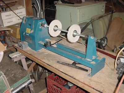

Before I had a buffing system I applied the stick buffing compounds by lightly touching the sticks to the spinning pen and move from one end to the other and then buffing with a piece of clean t-shirt. Worked fine, just keep the pieces of cloth separate. After 4 or 5 pens the compound is in the cloth and no need to dress the pen with the compound each time.
I finally made a buffing syttem to mound on an older lathe that was not being used. I have also mounted it on other lathes, taken it to demos, etc. It works very nicely for under $30. Take a look.
Do a good turn daily!
Don
