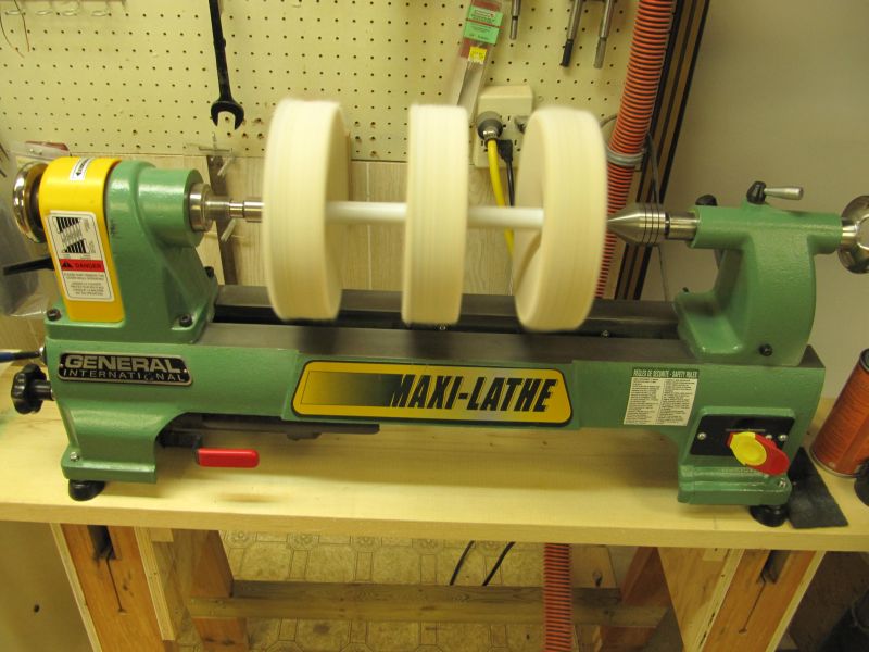

Do you mean like this?:biggrin:

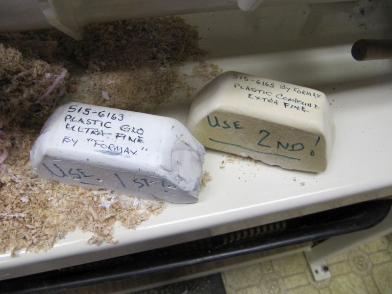

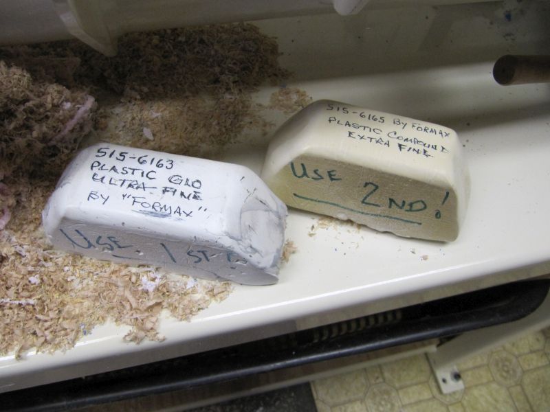

Here's what I use
both on Acrylics and CA finishes! If you decide to purchase a bar of any of the compounds, do it with a friend. The bars come in a GIANT size that would last one person for an eternity. So split it with a friend!
