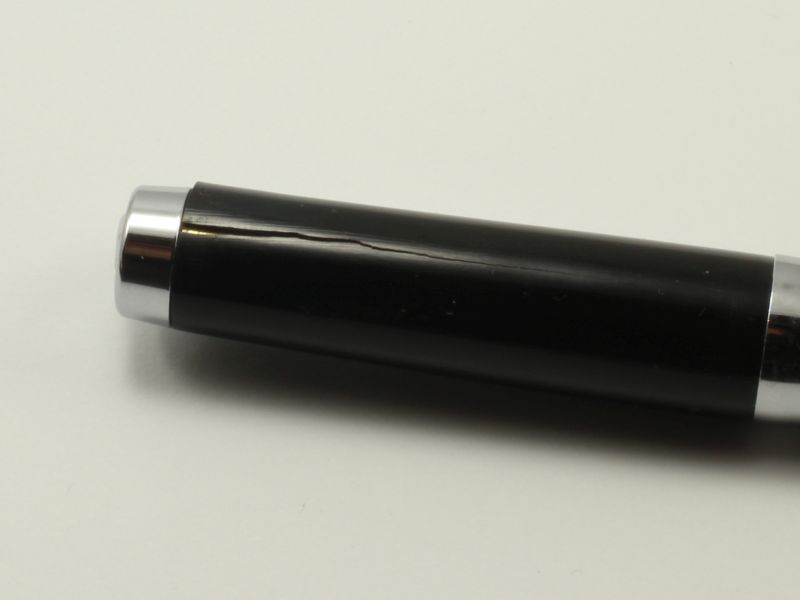

A number of months ago I made a pen using Buffalo Horn. It turned out nice. So I took it to work and put it in my drawer.
Fast forward to today. I grabbed that pen out of my drawer, and thought, gee that looks funny. I took a closer look, and sure enough it had split, on both sides, (only 1 side shown on the pic).
Why would buffalo horn split like that? It wasn't out in the harsh elements. In fact, it was well protected in the drawer.
Any ideas?
Mike...

That is distressing ! . No idea why that would happen unless the pressing in of the end cap stressed the brass tube, which in turn stressed the buffalo horn to the splitting point

That really is a shame. I do not know if material like that expands and contracts as wood does. Maybe there was just a hairline crack in when you made it and it just finally opened up if it was drying out. Not sure how much of a patch you can do without making it look noticeable.

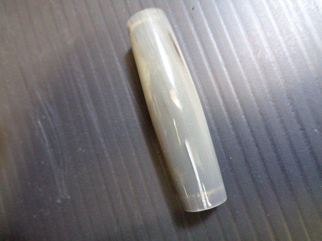

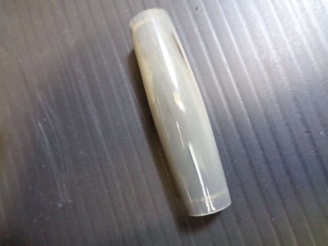

OK this is the truth. My wife takes about 20 of my pens to work to sell for me every day.She works at the Airport mid shift. First thing this morning she has 2 Buffalo horn pens. A Patriot Fountain and a Gatsby.One gray and one Black Both cracked. Patriot both blanks. Could not save either one. I will try the Buffalo Horn again on the Gatsby but not the patriot.Good part neither were sold yet.Here is the Gatsby.I took the patriot apart needed the tubes

Another Horn just cracked .It was the first one I made and I have been keeping an eye on it. It was an Art Deco Really nice pen I have 3 5" blanks left I will store them in wood Hardner for a while.But will not make anymore of them to sell right now
