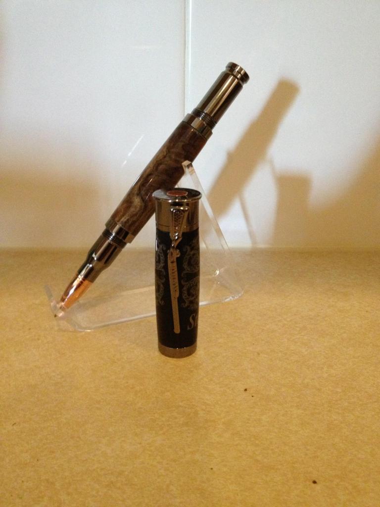

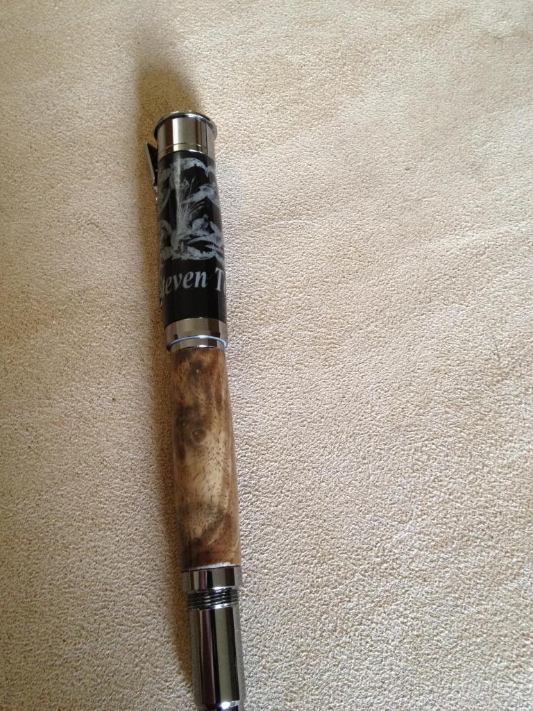

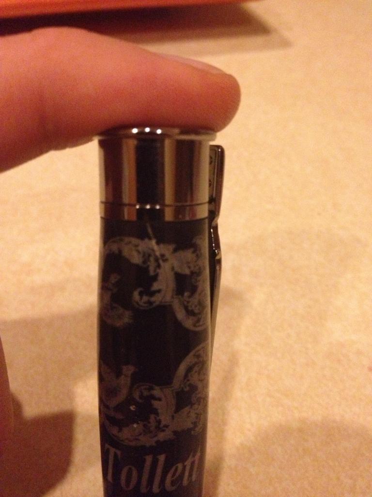

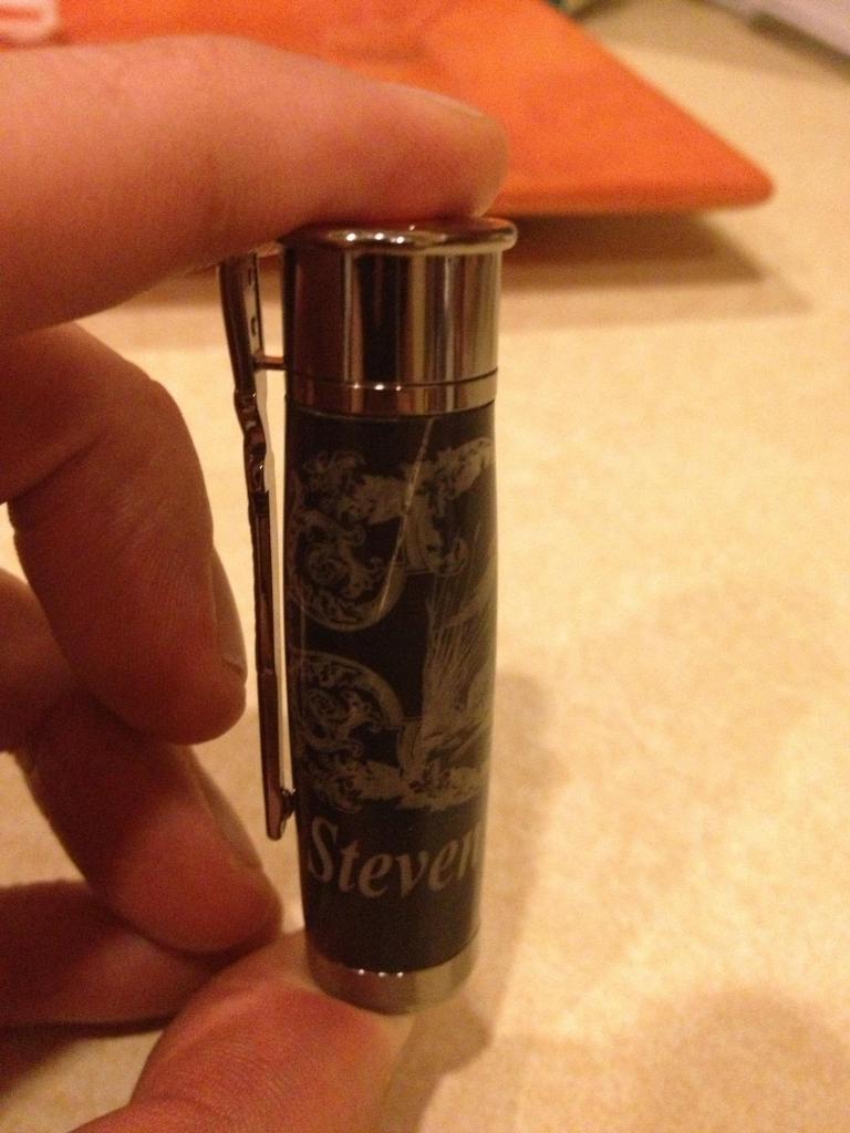

Ok so I bought some of the Buffalo horn round blanks from PSI to make a Father's Day pen for my Pop. I put it on a PSI Over Under Shotgun Pen, and used it for the shell end. It looked great, so I took it in to work and had some light laser etching of some pheasants and his name put on it. So its sitting here waiting for my dad to show up and the ##$% Buffalo portion is splitting:at-wits-end:. I only finished it 4 days ago. Now what do I do? I don't think I can take the cap apart because of the plastic parts inside the tube.
Questions:
Did I screw something up?
Is there anything I can do to fix it?
Is it just a scrap pen now?
How do I get it apart?
Is there something wrong with Buffalo horn blanks?
What should I use in it's place if I fix it or start a new Over Under Pen?

That is what buffalo horn does...it cracks. You're the second one to post about buffalo horn cracking in the last week or so. And, searching the forum for buffalo horn would probably turn up several mored threads about cracking buffalo horn.
I am so sorry you spent so much time and put so much effort into such a thoughtful gift for your Dad only to have the horn crack. I know you were disappointed.
You might be able to fill the crack with horn dust or crushed stone then drizzle thin CA over it. But more sanding would probably do harm to the laser work. It is possible that the heat from engraving may have contributed to the cracking. I am not one who thinks so but several do and will probably offer that as the cause. Antler may have been a better choice in material. I have not made an over/under so I can't offer any disassembly hints. I would think one of the camo blanks might work well with that kit. I wish you well and again, sorry for your disappointments with this pen. We have all has similar situations.

Sorry that your project went South. As an afterthought, horn of ANY kind or snakewood projects would never get near a laser in my shop. They are both TOO apt to split, crack or chip without agitation. Adding the heat from laser etching is just tempting fate too much.

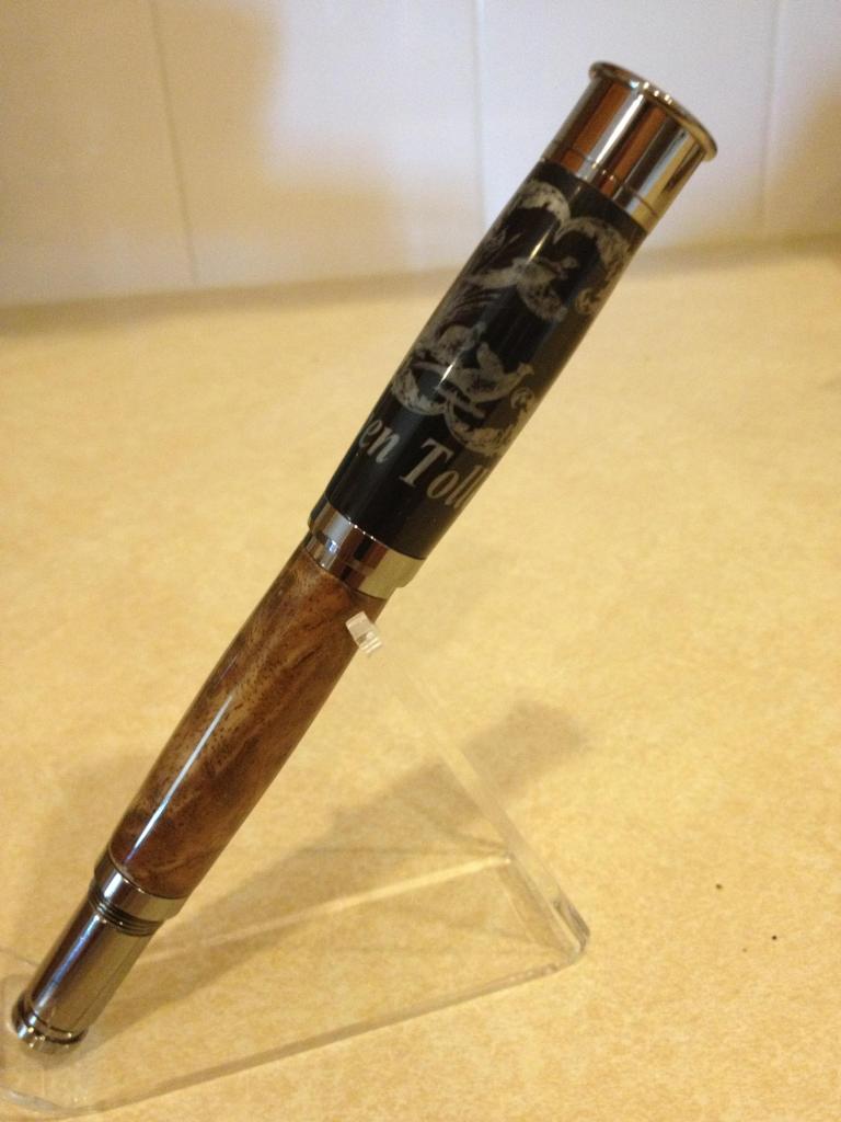

Thanks Guys,
I figured being that it was stabilized that it would be fine. I didn't even finish it with CA. I just wet sanded then polished. So now I'm betting that the whole thing is going to start splitting all over.
The good news is I got some pictures before it started to fall apart. I'm going to call PSI tomorrow and see if they have some suggestions for taking it apart. I just have to find a black acrylic blank locally, cut, turn, and then get it back in to work so my guy can laser it again before Friday.
Thanks for the help, learn something new with every pen I turn. I just hope now I can get it apart without trashing the kit. I would hate to lose the whole thing.
