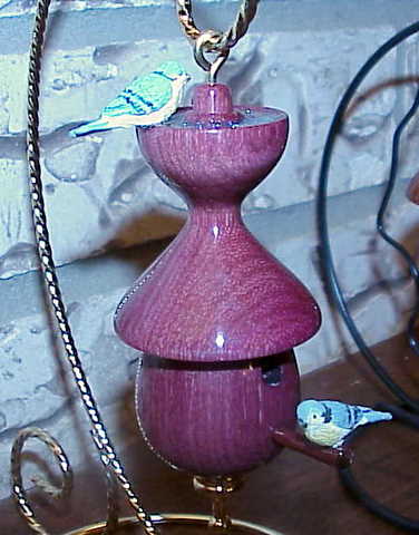

Every time I turn purple hart it turns more brown than purple. Can anyone explain why? I am posting a bad PIC of a purple hart bird house. The wood was much more purple before I turned it. All help is appreciated.

By the way, your photo looks pretty purple to me.

ross,either my eyes are worse than i thought or my monitor is crazy but the purple heart looks plenty purple to me.

The pic does look more purple than it really is but is not close to the purple it started out. I just cut a blank for a pen and turned the top. When I compared it with the bottom, it was closer to brown with just a hint of purple.
