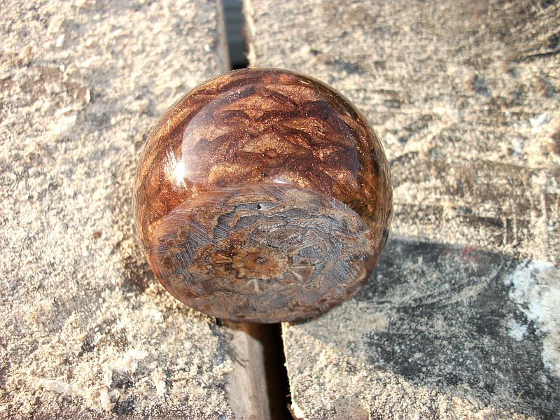

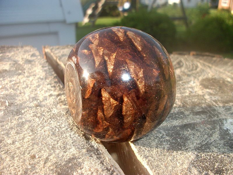

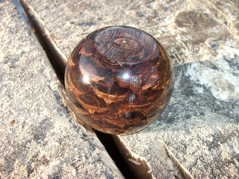

Hi fellas, I bronzed a pinecone and clearcasted it last night.Today I was working on the lathe,all went well.Took it off the lathe and tried to clean up the ends with my belt/disc sander.Could not get it flat,Allways a slight bevel on one edge.Kept trying to get it flat with no sucess,ended up over sanding it.If that wasen't enough my butterfingers let it slip away and go bouncing across the concrete.Pissed me off but I decided to buff it anyway to see how the clarity where it didn't get scratched and how the bronzing came out.
I am really happy about the cast.Really unhappy that I couldn't keep from screwing it up.
What do you think of the bronzing of the pinecone?

That is very cool. Extremely nice. Amazing. It doesn't look screwed up to me. It looks great. Thank you for sharing. If you want to screw up another one and send it to me for a price my wife has a paper weight collection. This would be great for it. Her birthday is July 2nd this or one similer would be an awesome gift. Just asking. PM me if you have an interest. Tom

Dale - the bronzing is excellent! It reminds me of Xmas ornaments.
And I hope you don't put it on a shelf until it is hand sanded and buffed! I suspect it will be a pain, but very beautiful and with no flaws in the end!
Nice process in the works!

It's getting passed aroud right now,even though it isn't fixed.Funny thing is if you hold it up to bright light indoors it looks ho hum iside.Let sunlight hit it,it sparkles and glows.

Bronzing is excellent . Very difficult to get a flat surface with a belt sander . Use a very light touch holding the piece up to the disc . I use 80 grit on a disc , then go up to 220 by hand with sandpaper lying on a flat surface . Less waste of time and sandpaper unless you have multiple discs set up , but you have to be careful to not start a new rounded edge .
