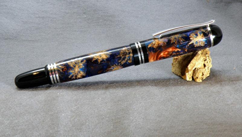

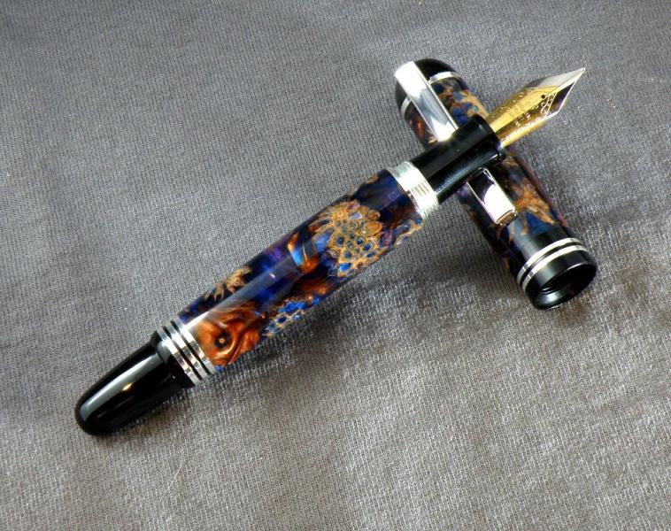

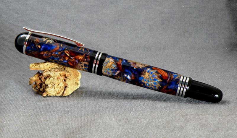

Today is my first day between jobs for 3 weeks. Instead of cleaning the shop, I thought it best to finish this pen that has been sitting on my lathe for a couple weeks. It fought me to the end, but I won! Not too many voids in the cones as I'm applying a bit more pressure to these when casting them. Where I messed up was in sanding and not cleaning the blank well enough before applying my CA finish. I brought it up to 600 then did the CA. Normally this works, but when I was done, I found the nasty marks. Brought it back down and skewed to a finish, then applied the CA. No sanding the second time around. Enjoy!!!

Eric that is a great looking pen. Those are a real pain when they aren't cast well. Good choice of kits to go with it as well.
ToddMR
May 3, 2010
1,715
Columbus, OH
Eric I like the colors in the blank combined with the cones. I think it looks like they belong in there. Really a nice looking result.
thewishman
Mar 9, 2006
8,183
Reynoldsburg, Ohio, USA.
Eric, that is a stunner! I cannot believe the depth of the colors on the cap - it is so thin, yet looks inches deep. The whole thing looks other-worldly. Very nice work!
wizard
Aug 27, 2009
3,569
Houston, Texas
Eric, That is absolutely beautiful !!! The colors and patterns remind of the life on a Pacific reef teeming with life and at another glance reminds of the vastly different frontier of space in the form of a developing nebula. I don't think I have ever seen a blank that beautiful. The components are perfect as it frames the beauty well! Would really like to see that on the front page.:)
