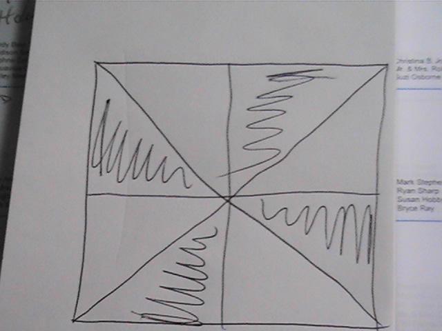

This works best when you make two blanks at once IMO
Take two woods that are the main "bricks". I used Jabota and Spanish Cedar. very close colors. Then cut both down the middle lengthwise take one of each and glue in a piece of veneer for a "mortar joint". Flip the blank 90 degrees. Do it again. Then do 45 degrees and then 90 degrees. So you should have something that looks like an asterik except it has 8 points. Every other piece is one wood. Then glue it like a stair step segment but put a piece of veneer between each layer. Hope that helps.

I wish I had pictures. Sorry. The big point is a slice of veneer between each cut. I do 4 cuts lengthwise through the blank then a piece between each layer of the stair step.

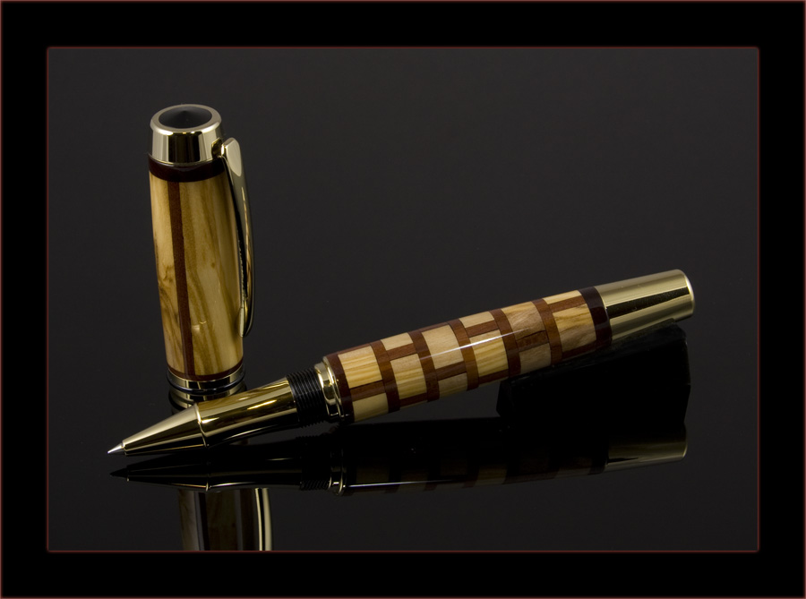

hewunch
Aug 5, 2008
4,663
Albany, GA
Here is a picture of the pen. Like I said, maybe I can make a blank soon and take pictures during the process.

You could cut a pen blank in half lengthwise and laminate it back together with a thin piece of a different wood in the middle. Flip it 90deg and cut it in half again lengthwise, laminating it back together with a thin piece of a different wood in the middle. Then cut it into pieces widthwise and glue them back together with a thin piece of a different wood in between each piece with each piece rotated 45deg from the previous piece. At least that's how you could do it using the tutorial that Bruce posted.
babyblues
Mar 8, 2007
658
Portland, ME, USA.
babyblues your way would yield 4 bricks per layer. My way yields 8.
Oh yes! I get it now! You make FOUR lengthwise cuts instead of just two, one every 45deg with laminate between each cut. I couldn't understand what you meant by it looking like an asterick. Then you cut it into pieces widthwise and glue them up with laminate in between with the pieces rotated. I got ya now.
