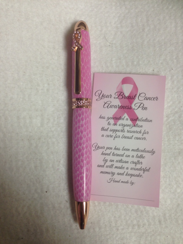

I did a few kits. All worked out well. As mentioned earlier be sure not to invert tubes. I tend to gift these to BC patients/survivors.
