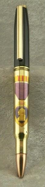

I have been using CA for the finish on my imaged cartridge pens for over two years. IMO powercoat is the best finish for blank cartridges, but the heat required to fuse the powder melts the the decal on my imaged pens.
The attached picture is of my Purple Heart Pen (from Vietnam) that I have used daily for over a year. The finish is as good as the day I applied it.

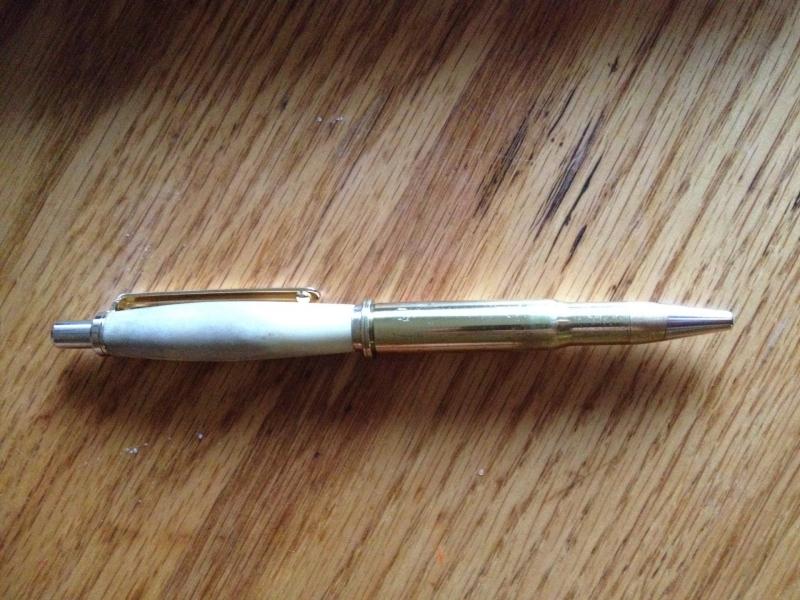

Does anyone know who can make real bullet tips for a .30 cal casing? I am using 30-30 cartridges for my click pens. The woodcraft kit tip is just a hair too big, and it doesn't look very authentic. I am just a big click-pen fan.
