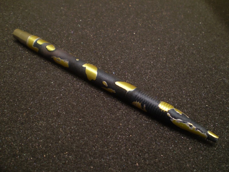

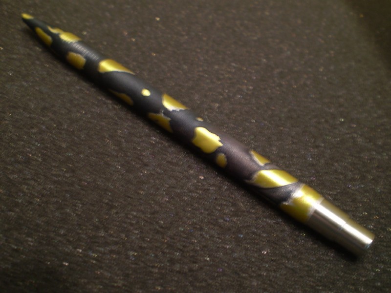

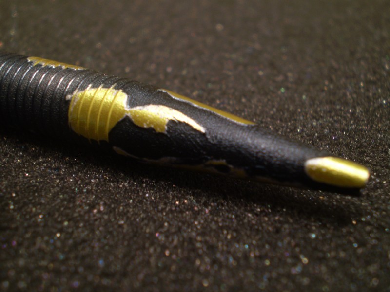

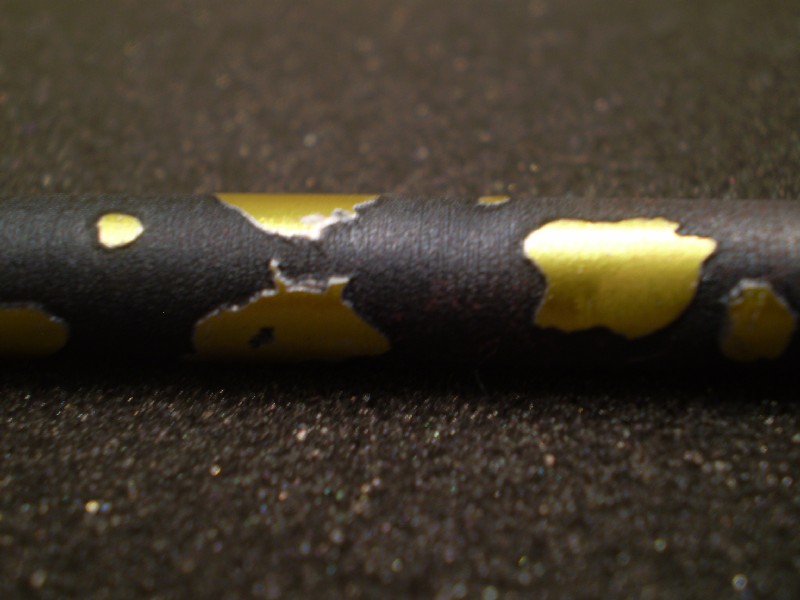

A kitless click in aluminum anodized in 2 colors!!!! Yes, you heard right, 2 colors! Mike Redburn and I were inspired after seeing a few colorful pretty butterflies in different colors on a black background done by Brad... We figured we should step up our game a notch :biggrin:.
This was my first kitless click I turned, and we anodized the yellow-green color first, then masked it and anodized the blackish-blueish after. Lets just say things didn't quite go as planned, the pen looked much cooler before all of the dye somehow washed off the pen :mad:. Special thanks to Mike for putting up with me for the hours using his anodizing setup...
The pictures aren't great, I am still working on it, but it gives you a general idea. I included a few closeups so you can get an idea of the texture of the pen. Please comment and critique the pen. Be as harsh as you feel is necessary, I appreciate honest information, you won't hurt my feelings!

hey hey! great shot at it. my guess would be that the pores were partially closed when you applied the second dye.
what was your process?

No thats over etching and it was planned that way.:rolleyes: Yeah thats the story. Actually Brad, after the results I did some more research to see what was what. We were following an effort Marshall had seen on You Tube. Unfortunatly we didnt have all the information right. However the first thing that I learned is that the acid bath is supposed to be between F 60-70 degrees or C 15-21. My shops ambient tempature is 85 degrees +(30c). That causes the pores to be to large and lets the dye run out rather than seal. Also the process of 2 colors in this case uses bleach to remove the unprotected color and a dip IN (ahem Marshall) Muriatic Acid (hydrochloric) to Open the pores of the anodizing for the second color. Our resulting efforts on the second color caused the etching of the surface. The best part is we tried. We had some success and learned a great deal about what to do and what not to do.

It looks like it has a rash. Does this look infected to you? :tongue:

Figured it would have been the second colour :) Bleach works on organic dyes, but i presonally avoid using hydrochloric. i find it too aggresive. Instead i use very diluted sulphuric acid to open the pores up. any solution too strong damages the pores and creates pitting.

We swirled it in the anodizing acid bath for the second color as we didnt have the information about the muratic acid at the time. Maybe I should maek/use a weaker solution.

A weaker solution would have been more ideal but even so your anodising tank solution should have been fine for a short duration. how strong was the bleach?

I would feel more comfortable assuming that's your issue. If you are going to use bleach dilute it 30% bleach. Either that or just use weak sulphuric acid. Some splash anodiaers I know swear by using nitric acid instead of bleach.
When using the bleach at full strength it should have removed the dye inatantlt. If it took a while its likely the dye is not organic and acid is a better choice

You found the videos Mike! Well done! They are pretty informative, though I didn't see this particular video. Looks interesting... Seems like we are stuck in one of those grey areas where it technically should have worked, but technically it should not have. All I know is something was a little off.
The weird thing is that it took the dye the second time around. The pores had to be open because when we pulled the thing out of the dye it was a nice blackish blue color, so that worked. The problem was once we tried to seal it. I think that is more what we should look into than the bleaching of the rest of the first color. If the pores were not open as they should have been then the color would not have gotten on the aluminum at all, it would have stayed silver after dipping in the dye.

So the two interesting things I found from the video are the hydrochloric he used to reopen the pores, but also the nickel acetate sealer he used. I think this could possibly be the key to our failure. The boiling water was our problem, maybe the nickel acetate gives a better seal and keeps the dye from "leaking" off the part as much as it did. Just an idea, we will have to give each variable a shot

Try steaming it for a while before submerging it. its one way to give it a head start without losing any dye whatsoever. I do this with certain colours

We had better luck today. I will let the pen owner post the results. However we cooled the acid bath as it was anodizing and that made a world of difference.
