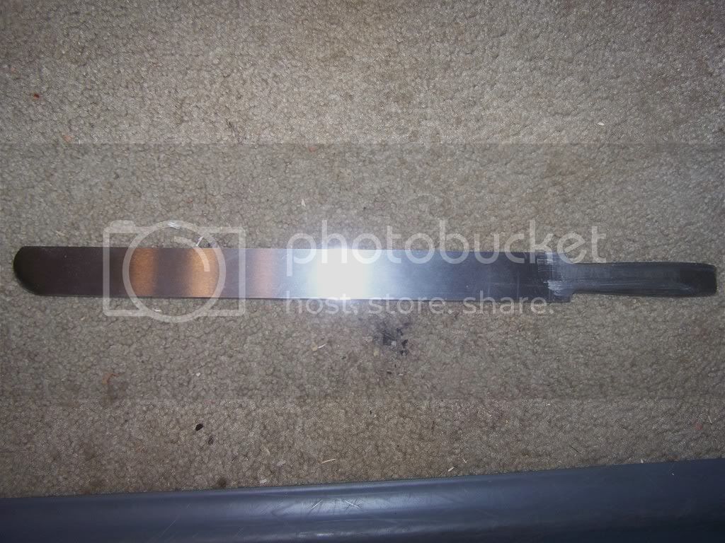

Bowl Scraper I've been working on
Aderhammer
Dec 4, 2007
541
Allentown, Pennsylvania, USA.
Just got the steel today. 3/8" thick, 1 1/4" wide, 14" inches from tip to start of tang. Made it out of A2 steel(man is this stuff hard!) It took me over an hour of grinding with a 36 grit wheel on a 3450 rpm bench grinder to get the tang to where it is now! Still have to make a handle for it, tested it on some end grain on a madrone "burl". Cuts like butter, almost no tearout which is very hard with this madrone.EDIT: was in a rush and forgot the pic[:I]

if it took an hour to get the tang like that; how long did it take to grind the cutting edge?? (or is tang = cutting edge??)

The tang is the part of the blade that goes into the handle.

Did you purchase it already hardened? I found the same thing at McMaster-Carr but it is in an annealed state (soft).
I believe A2 "air hardens" if you have a way to get it up to the proper temperature. A little research would get the temperature.

Getting that stuff in an annealed state would be very ideal ... annealed, it would be pretty soft and easy to work and drill. Then, you take it up to non-magnetic and let it air-cool to harden it ... the issue is that it's difficult to temper properly, as it's an air-hardening steel, so it may remain somewhat brittle and could break during use.
I was thinking about purchasing a thick piece of damascus steel at some point and working that into a tool, but I'm pretty sure carbide would last longer between sharpenings and be much easier to maintain. Of course, if you ever decide to try something like damascus steel for your tool steel, keep in mind that grain orientation is of vital importance. You don't want your layers delaminating as you work!

Search you tube for "Big Ugly Tool" for videos by Robo Hippy using Tantung steel silver soldered on a big bar.
No heat treat needed.
