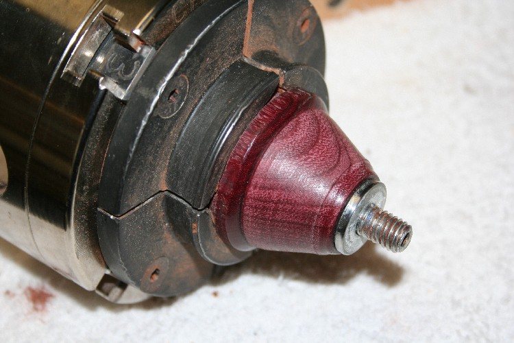

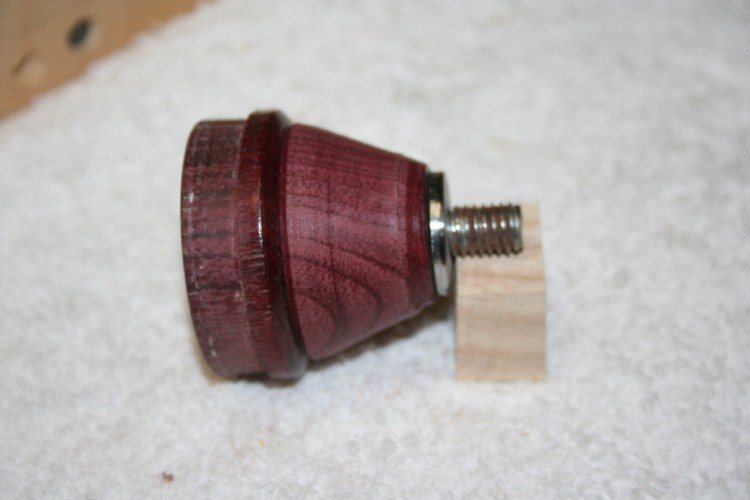

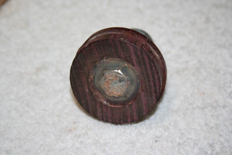

Eugene,
Here are a couple of quick photos of the homemade mandrel.
The washer on the front is very close to the diameter of the stopper base and I use it for a gauge.
The bolt also has a washer in the back for the head to compress against. You can use a nut on the front to tighten the bolt so it remains relatively straight when you glue or epoxy the head in the back. After the glue sets, remove the nut, true the mandrel on your lathe and you are set.
The nice thing about this is, I can make 30-40 mandrels from scrap wood and .10 to .15 cents worth of bolts and washers (per mandrel) for the price of one $4 commercial mandrel... not counting shipping... and I can leave a stopper mounted for whatever reason and load up another mandrel and stopper in a few seconds and continue on.
If you do not have a jaw chuck, then perhaps one of the other methods would work best for you. This is what works for me based on my equipment and turning techniques/style.
Dave

Originally posted by Aderhammer
Dave the only problem i might see is that if the wood shifts over time, it might not be perfectly true.
Andrew,
This could be an issue with some woods. I make mine from dense hardwood scraps (Oak, Purple Heart, etc) so the tendency to change is lessened, not to mention that the surface of smaller pieces also reduces the movement potential. However, because they are so inexpensive to make, all I have to replace is the scrap wood and re-use the bolt and washers.
I forgot to mention previously, I tap the homemade chucks as well... and ratchet the bolt down, with the nut temporarily on the front during the gluing. The glue from the back keeps the bolt from backing out... also eliminates the need for lock washers, etc..
This gives me additional strength when using the chuck. The Purple Heart chuck in the photos is over a year old and all I have had to do is trim it for additional clearance for some of my more recent designs.
Dave
