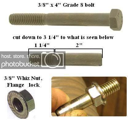

Hello, was wondering if someone could give me a list of what I would need to start turning bottle stoppers along with where to purchase the items needed. I already have a Jet 1220 VS and have only made pens up till now. I alson have the PSI collet chuck, a Oneway Talon scroll chuck an Nova live center, a Jacobs type drill chuck and turning tools. From what I gather I need a stopper mandrel and some blanks. I now there are several different types of stopper mandrels and was wondering which one I should start with? Also, can anyone suggest how to dye wood? I like the looks of the dyed bottle stoppers.

In addition to the great stuff that Ruth (torne-lignum) has, PSI, CSUSA, AS, etc. also sell stopper mandrels. Most of these are interchangeable, as far as I know, although the stud on the CSUSA stopper bases is a little smaller (diameter) than the rest.

I have found that I like PSI best for stopper supplies. Their stopper mandrel is great, a very good selection of stopper kits and blanks.

Chuck a piece of scrapwood (1.5x1.5" ish by about 2" long) in your scroll chuck. Turn the end to fit the hole (I use 5/16") you make in your blank. AFTER the stopper is turned, make your hole fit the stopper you have chosen. (Redrill and tap if necessary)
You can make MANY of these, for all your projects and save LOTS of freight, shipping mandrels.
Or for about $1.00.....

That's a great alternative, Justin.
I have never had good luck with threads on things I turn. But, it IS an accepted way of doing it -- so to each his own!!!!
Cheap, too!!!

I did look at the PSI mandrel that screw on to your lathe spindle. Do you think it is a better option than using one of the others?
You wouldn't by chance have a photo of what you are talking about? Sorry, Im new to all this turning stuff.
