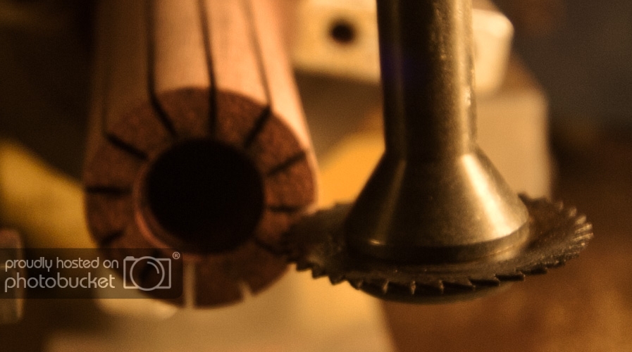

Boring bars
I have a couple dozen boring bars , and I have live cutters set up on two of my lathes from live cutting threads to tapering and machining wood parts .
I grind mine some of my boring bars to make them the size I want ...and to make sure they are sharp and will not vibrate or chatter while cutting the wood .
All the holes I start are cut with a drill bit , I use a 5/16 3 fluted bit for the SS steel 3x10 pin I set in my pool cues wood to wood joints.
I am drilling setting a 3in stainless steel pin to less then 0.003 run out on every cue I make .. .
The drill bit is a 3 fluted carbide bit I put in my tail stock .
Very special bit , to do one pacific job .
No offence to anyone but a production goes if given the choice of drilling to size or using a boring bar and boring to size , I would go with the drill bit .
The one and only pen making arbor and collets kit I bought and the drill bit was bent ..
I believe the kit had been returned that I had got .
Straight Up I only buy certain drill bits for certain jobs..
The market is flooded with cheap POS drill bits .
I buy allot of my stuff from machine shop supply companies direct.
And I think my money goes farther that way and I get higher quality cutting bits and drill bits ...
I ended up buy three arbors to find one company the sells one that is actually runs true .
Getting the right tools for the job is extremely important when it comes to machining fine cuts .
PS good example of shooting wide open or the lenses lowest F stops, make for a extremely shallow or thin focal plane.
Everything before and behind the saw blade which by taking this photo I realized I had mounded the saw blade on backwards is out of focus .
Which isn't the normal if you are doing pen photography ( F 9 to F 11 )
I swear I can do some Dumb @ss stuff at times.
Machine safely ... because all these open saws a router bits and lathe spinning around make me nervous .
