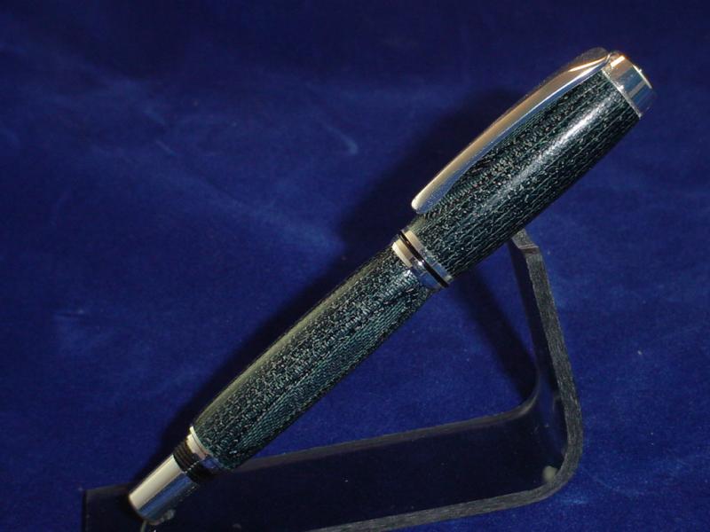

Could look a lot like this:
Probably a blank I purchased about 2005?? I had several.
Denim with thin CA "overcoat", sanded to 1000, then buffed with tripoli and white diamond.

Jon-wx5nco
Oct 29, 2009
351
Tulsa
Ed,
Thats kind of what I am looking for. I have a few pair of wranglers that have... well... become well "air conditioned", if you know what I mean. Instead of throwing them out, I'd like to do something with them. I think pens would be the perfect use for them. Thanks for showing me that picture. With that, Lin's and Mike's help, this is getting me on the right track
