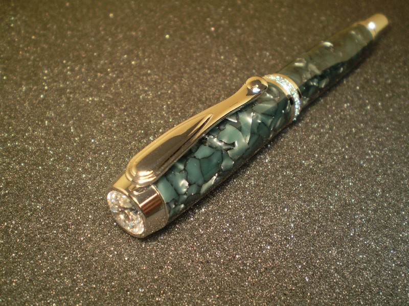

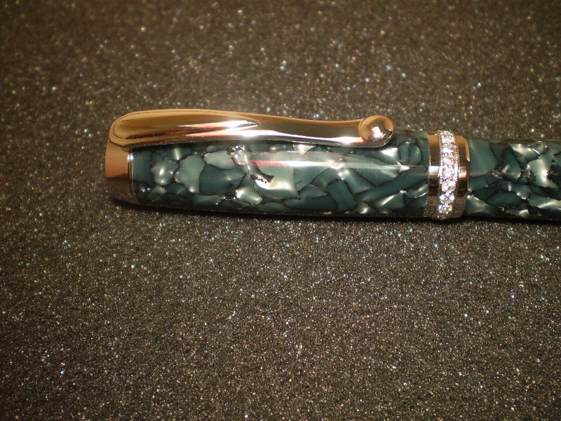

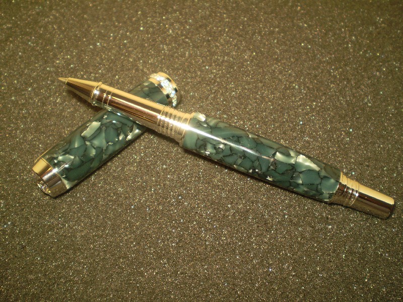

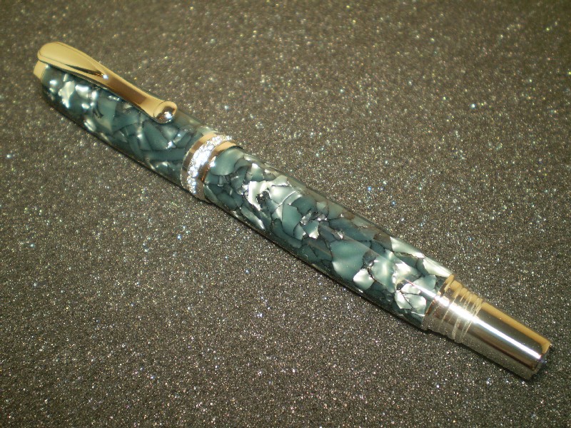

I recently bought some Mazzucchelli cebloplast and figured it would compliment the Venus kit perfectly, and I was right! The cebloplast has amazing depth and a look like no other, one of my new favorite materials! But it does have it's downsides also...
The cebloplast is 16mm in diameter and the finished size of a jr kit is about 14.3mm, so it doesn't leave you with much room for error. The cebloplast was pretty difficult to drill as well because of how easily it melts.
I hope you all like it as much as I do. Comments and critiques appreciated!

Cebloplast was the material that made me reach for a water bottle as I drilled!! (Remember at that time there WAS NO IAP!!!) Today, I still recommend the water bottle, with a dash of liquid dish washing soap.
Which brings up another point: IF you use water while drilling, be certain the hole is completely dried by the time you glue in the tubes!! Particularly if you are using CA, as it will accelerate (spelled: the tubes will freeze in position) as you insert the tubes, if the "hole" is still wet.
This is NOT the most "turner-friendly" material, but that pen shows why it is worth the effort (along with making you a better "penmaker" with each skill you develop!!).

Same here Ed! I went through about a cup of water with a little soap in it! Still took me about half an hour to drill to keep the temperature down. And luckily I made the CA glue mistake on another pen so I knew better on this one!

As mentioned, Cebloplast can be difficult to deal with, but it looks simply mesmerizing once carefully polished. Very nice!
I have a Venus just sitting here waiting for me to figure out which material to use, but you've solved that one. I think I've got some coral colored Cebloplast and the blank vault that might look nice.
