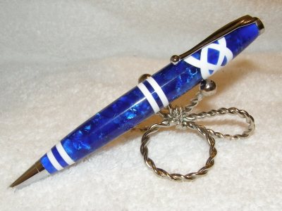

Thanks everyone!! Hey Oscar I learned to do them on here, basically you need to set up a sled for your table saw, to cut at a 45 deg. then laminate piece in flip 180 and cut next piece, laminate, flip 90 cut, lam. flip 180, cut, lam. then turn. Thats it in a nut shell.
Its really not as hard as it seems, just time consuming, and you need your pieces the same thickness as your saw blade. You can search on here for a tutorial. Thats where i learned
