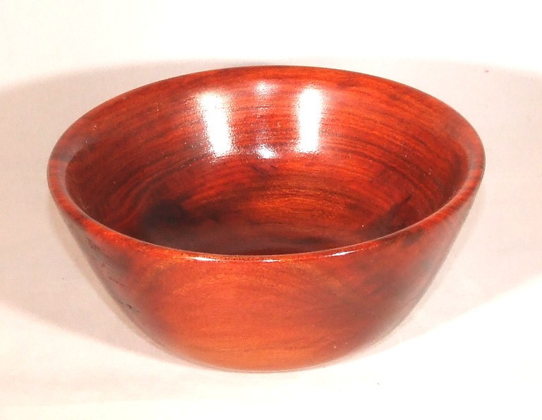

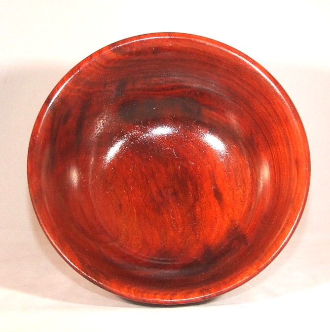

The bloodwood I've worked with has been much redder than that... most I've used in glue-ups for pepper mills but do have one small bowl in Bloodwood.. I usually look up woods that I work with either in Kestrel or Hobbit house to get info.. this is Kestrel's write up on Bloodwood... I have a piece of wood I got from CSUSA about a year ago marked Satine that is more pinkish than red...
----- beginning of Kestrel quote ---------
Bloodwood (Brosimum rubescens, - Brosimum paraense) This wood grows in tropical South America. It is also known as cardinal wood or satiné. The heartwood is a deep, rich brick-red color. It is noteworthy in that it keeps its color over time and doesn't brown-out as do many of the other red-toned woods. Bloodwood is a hard, dense, heavy wood with a very fine, even texture and takes an excellent finish from the cutter. Odorless and tasteless. Very hard and heavy. Weight 56 to 66 lbs. per cu. ft. Very difficult to work but finishes smoothly, taking a high polish. Rare. And expensive. Tropical South America -
------end of Kestrel quote--------

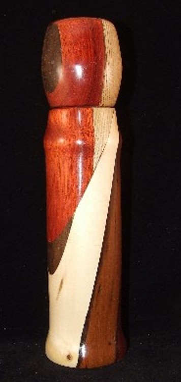

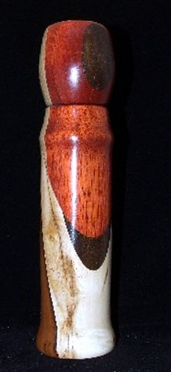

This is the little bowl I have in Bloodwood along with one of the peppermills
I got the Bloodwood from a local supplier in Knoxville... it was a board 8' x 12" x 2" thick.. very very dark red and weighed about 65 lbs. You can see how dark the red is. I don't remember any odor with the wood, but on the peppermill it's only part of the wood and any odor would have been masked by the other woods probably anyway.
