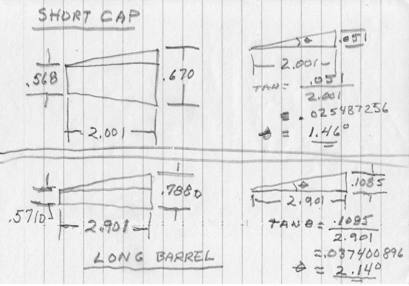

--- this is my rough sketch of the PANACHE long and short barrels as measured with micrometers. Diameters and lengths are shown in inches.
--- as I was using a metal lathe, I wanted to know what angles to set the compound at;
thus the calculations on the right of the sketch.
--- to covert the inch measurements to millimeters divide the inches by 0.03937.

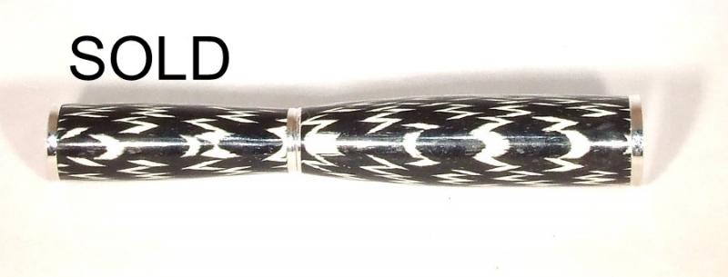

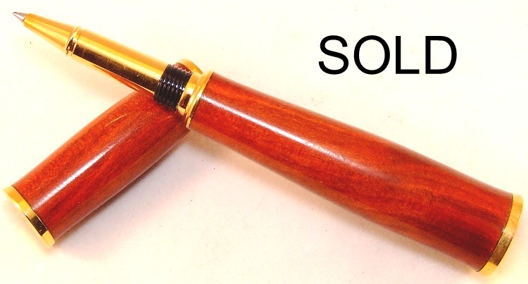

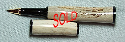

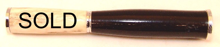

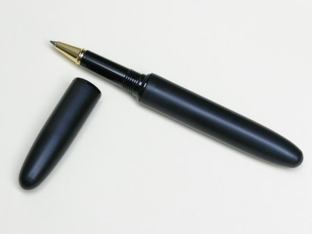

I've made 4 of the Panache pens.. they are definitely an interesting pen to make. Because of the size, I think I started with 1" or larger blanks in all cases except one.. I made one from deer antler, 1 from Honduras Rosewood, and 1 from Water buffalo horn. The water buffalo horn blank was less than 1 inch, but same size or just larger than the largest diameter end piece... problem was I under turned it just slightly and was never satisfied with it, so eventually took it apart and remade it in an ECLYPSE man made blank from Woodcraft/CSUSA... that one made a nice pen. They have all been sold, but here are pictures of my attempts.
Also, think I cracked the cap on the water buffalo, hence the antler cap... this is the one I took apart and remade into the black & white Eclypse blank.
