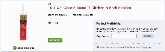

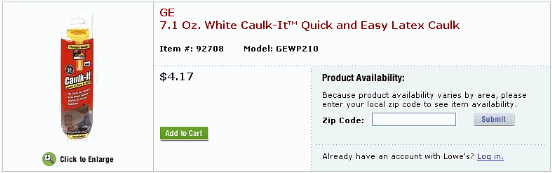

I find this topic very compelling and challenging. Usually the most elegant solution to a problem is the “simple solutionâ€. This may be the case here. Perhaps using a silicone or latex adhesive, such as, caulking, which can be purchased at any of the big box stores, would be the “simple solutionâ€. For the low cost, this certainly would be worth trying, without putting out a large amount of ca$h. These types of adhesives are certainly ‘flexible’.

Bozz,
That is a good idea.
