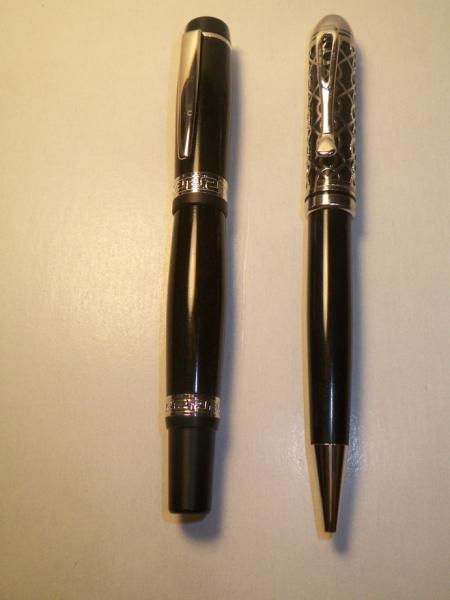

While ebony is hard to work, when you can finish it without it cracking it is amazing, particularly in a Rhodium pen. But you can turn several pens before you get one without cracks. Sand SLOWLY, don't let it build up any heat. Here are a couple of ebony pens I did quite a while back.
And another possibility is spalted buckeye burl. It can be hard to find and expensive even if you find it. However, it can be black with accents that make it quite beautiful. It is a wood I use very often on my high end pens.
