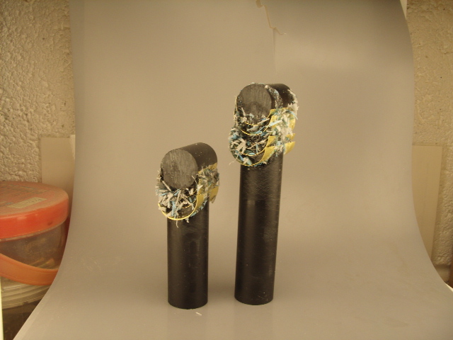

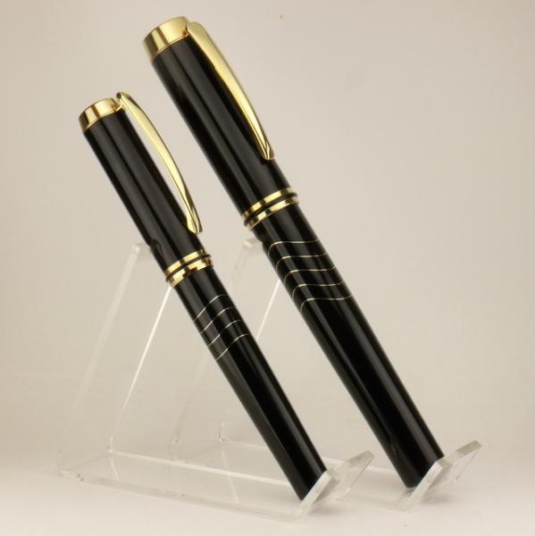

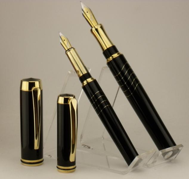

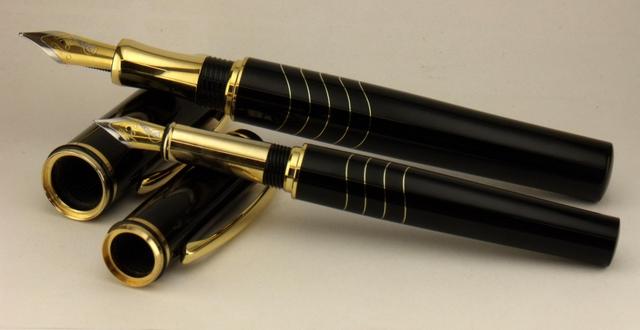

These are a full sized Gent and a Baron FP. The gold waves are thin brass shim stock. I did 5 segments on the Gent and only 4 on the Baron. Done with a router ( as usual :wink: )
Hope you like.

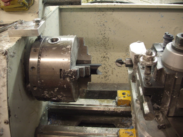

Nice design Skip, have you thought about matching waves on the cap? The 4 wave in particular.
Mike, that believe it or not was the original plan....5 on the body, 4 on the cap. BUT.....being rusty and all, you can see in the pics where it all went wrong. I turned both finished blanks down to confirm that there were zero gaps but turned it too thin to make a Gent cap.:redface:

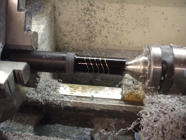

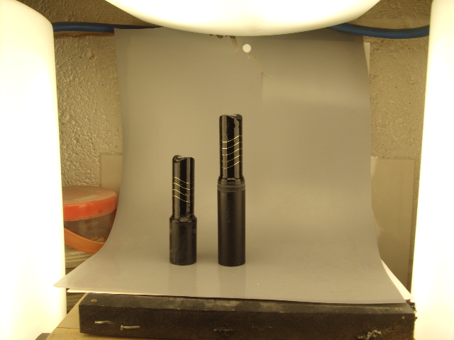

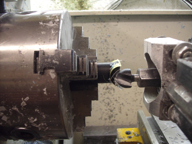

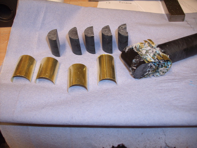

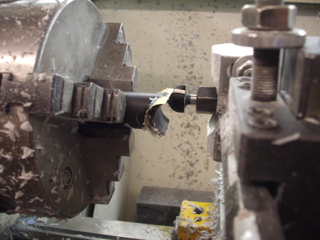

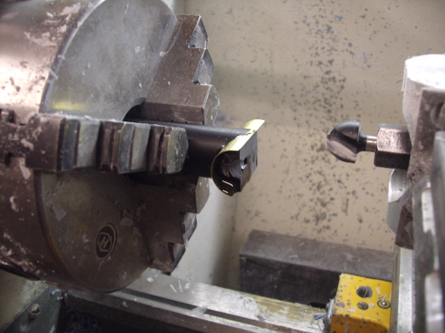

Really simple. Looks more difficult that it was.
Router mounted in tool post on centre line. The photo's show the rest.
EDIT IN; I guess I should point out that the lathe is used only to index the blank and to hold the router. It is unplugged.
The chuck is held in the same place for all cuts, but the leadscrew is advanced by 4.5mm for each segment
Thanks all, it's wonderful to be back too !!! :wink:
