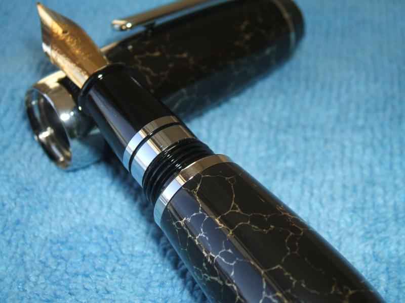

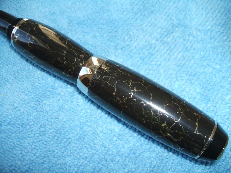

WOW! ~ This stuff is tough to turn. It got to the point that I didn't even turn off the grinder...............I couldn't go 2 or 3 passes without re-sharpening my chisels.......
But, a little patience & I finally won!! I don't know what was harder, turning the pen, or trying to get a photo of the detail...........
Gotta love a challenge. Let me know what you think ?

Well, whichever was harder, it looks like you did well on both.
Nice looking pen, and the photos do show the detail well (although they don't give you much of a sense for the whole pen :)

I think that is the nicest El Torro I have seen. I have a couple of those kits laying around, hhmmmmm. Good work.
