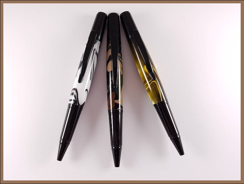

Three black Scirrocos, I really like this kit.

Those are very nice, especially the fit and finish. Really good choice of hardware and blanks too.
Any hints on how you got the blank/barrel to fit so tight to the kit? Did you bevel the ends? Just wondering 'cause mine never fit that good.:biggrin:
Any hints on how you got the blank/barrel to fit so tight to the kit? Did you bevel the ends? Just wondering 'cause mine never fit that good.[emoji3]
Rod
Thank you, no I don't bevel the ends I always use a micrometer to measure the kit and turn down to that measurement and don't rely on the bushings. I square the ends of the blanks using a flat sanding disc in the headstock and a rod with roughly the same diameter as the inside of the tube held in the tailstock. Hope that helps.
