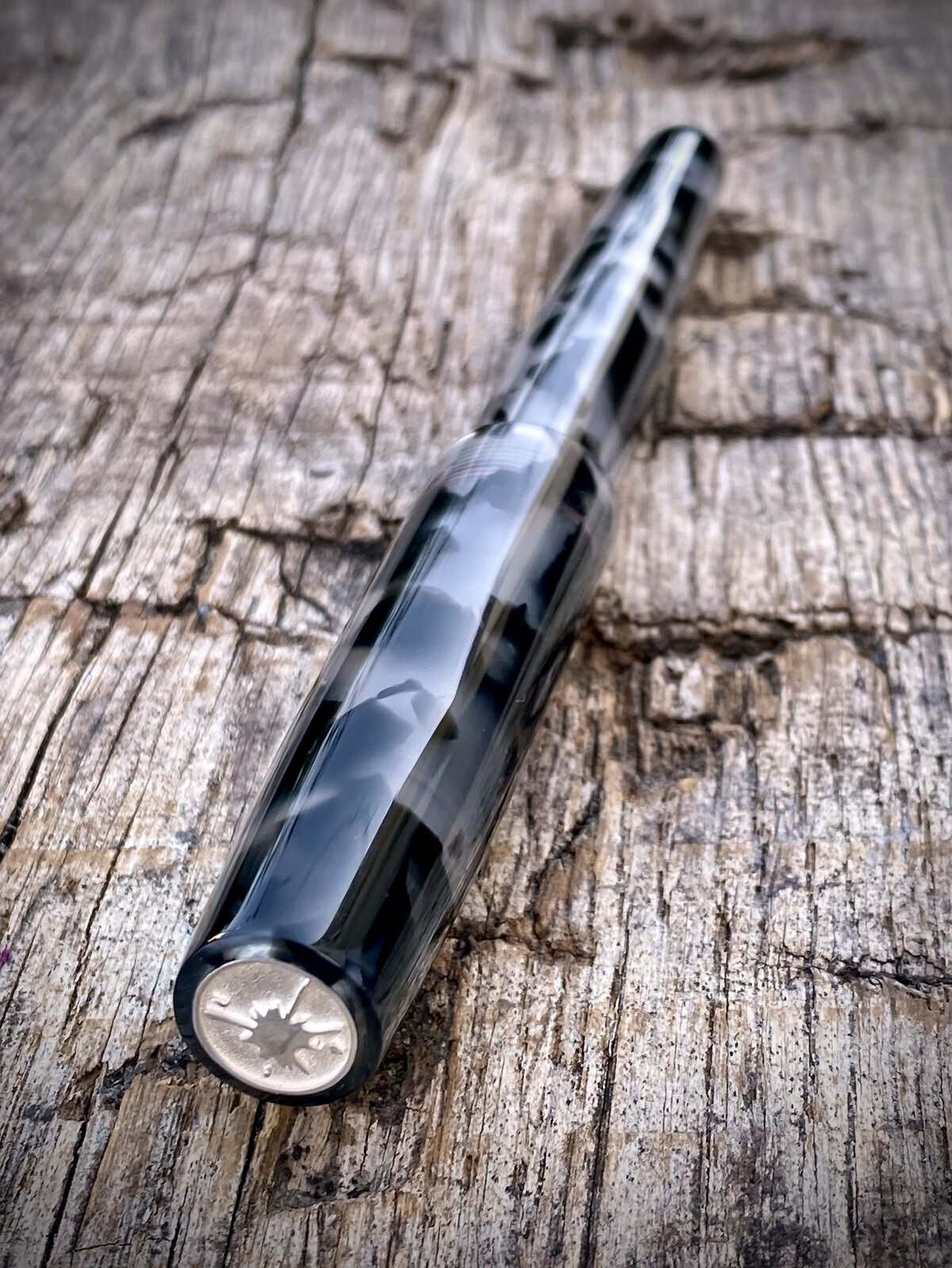

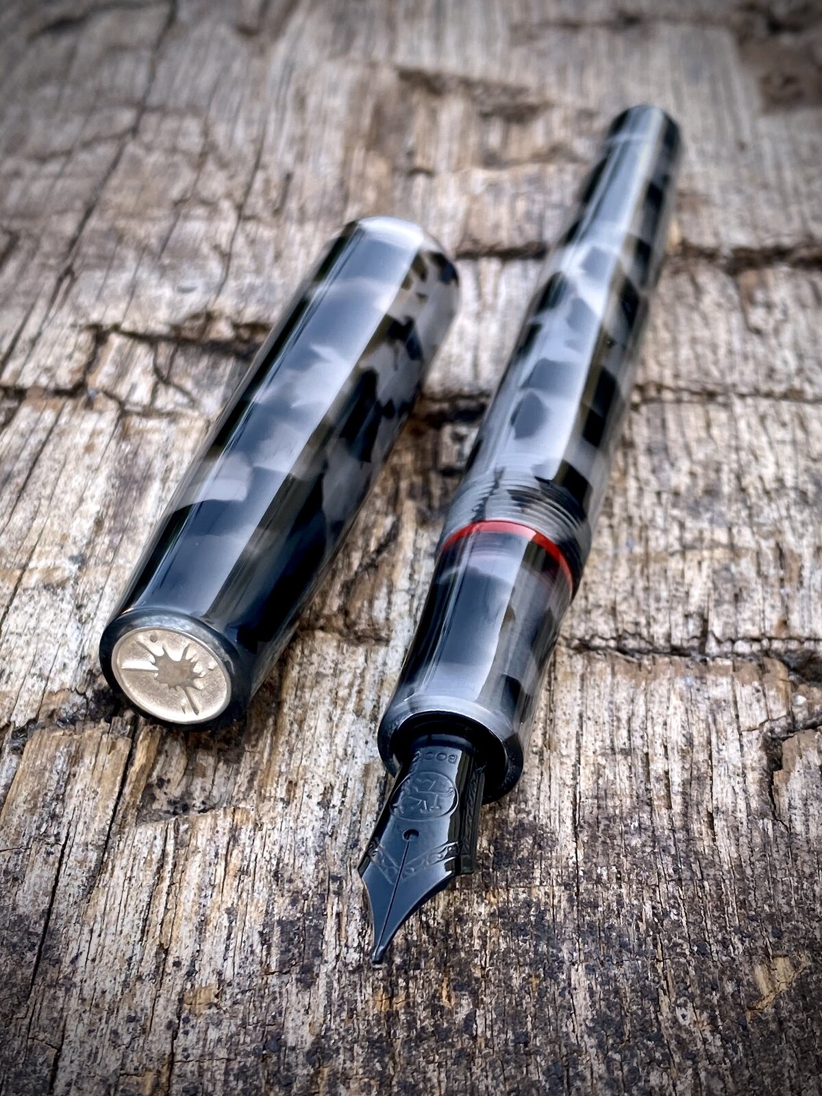

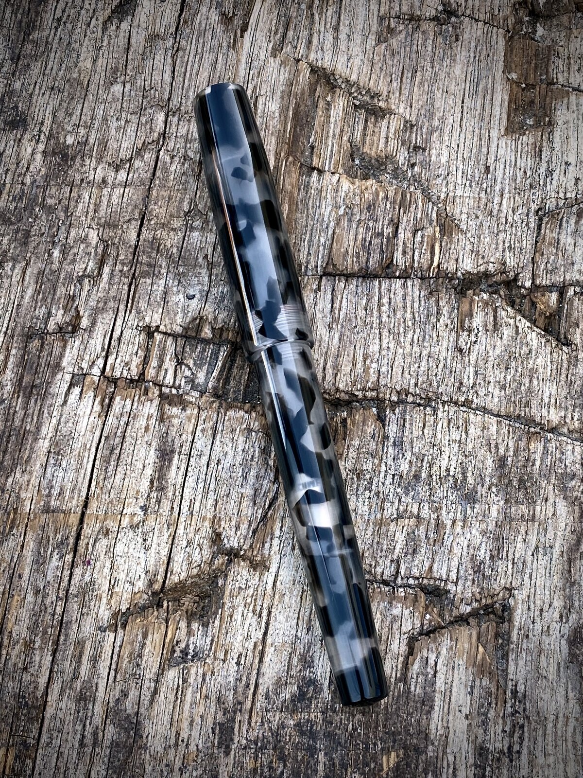

This is my signature pen model, based on my dog Rocky. He's a black and silver schnauzer and wears a red collar. He's a big part of life around here.
I once read that:
"Everyone thinks they have the best dog. And none of them is wrong".
How true!

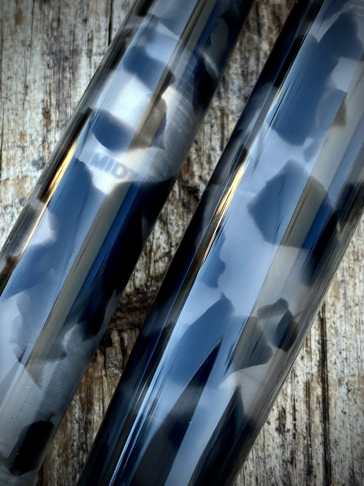

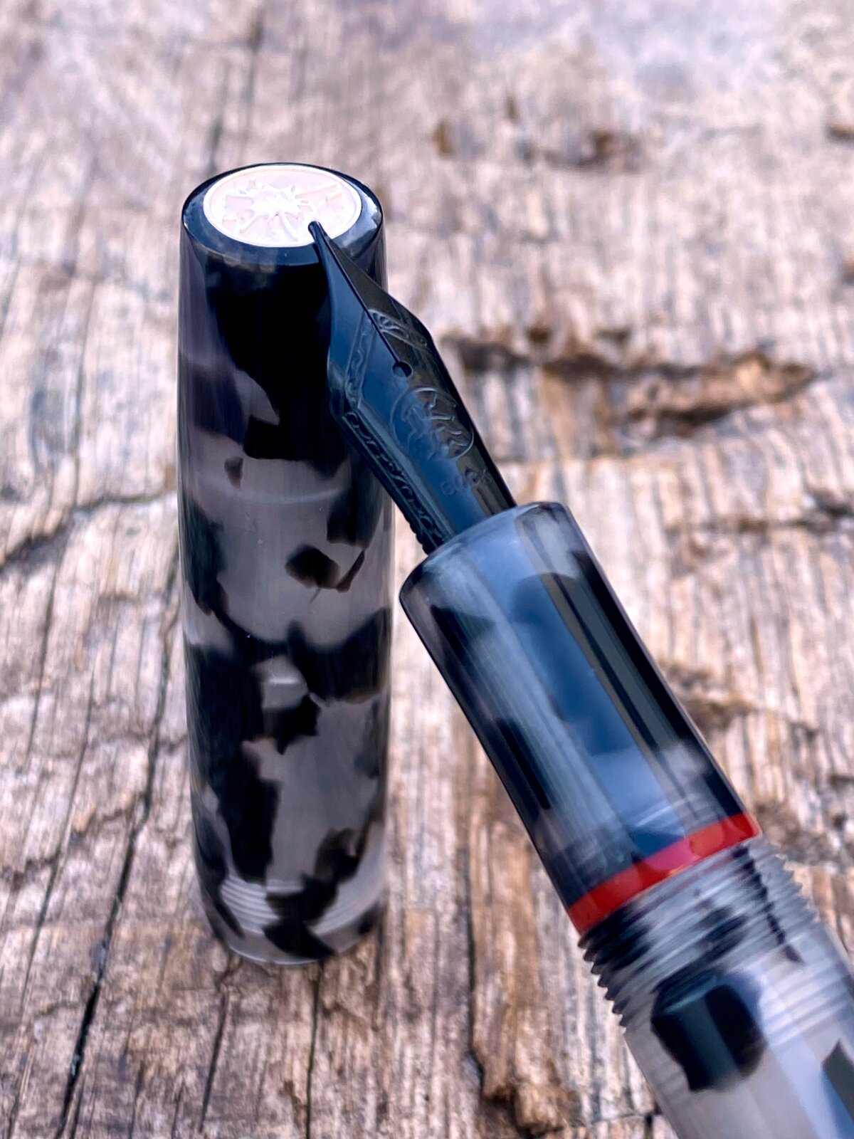

Anyway here's the pen. Pretty straightforward. 13mm diameter barrel with triple lead cap threads. Cellulose acetate with acrylic red accent and 100% recycled sterling for the coin. Fitted with a black Bock no6 nib fed by cartridge converter.

I really like your implementation of accent color. Many of the other postings I have seen of yours have body and cap finials in corresponding colors. So this is nice to see from you, being all cellulose acetate including the section. I started on a pen with the same material, this is inspirational and possibly a reason for me to quite while I'm ahead and let my project rest in the some day pile. Great work as usual, thanks for showing.

Thank you.
Yes I do tend to go through different phases of making pens in all the same colour vs using complimentary colours. I've done hundreds with silver accent rings and now I'm going more towards coloured accents for a while too. It's nice to change things up now and then.

I use acrylic rods (pen blanks) to cut the rings on the lathe.

Thanks Ash - are the rings permanently attached to the section? I'm wondering if epoxying sheet acrylic to the end of the blank before drilling and turning would work as well? (Thinking of a design I'm working on)

There's a high risk of the ring being torn off as you work on it - there's only a tiny surface area for the glue to hold and the shear/twist forces when you're drilling through material can exceed the holding strength.

Yes the ring is glued to the section, around the threaded tenon.
And yes you can glue sheet to the end before turning but if you're asking about this specific case on my pen it wouldn't work because there's a threaded tenon sticking through it. However you can add thin veneers to blanks for decorative purposes - just ensure the surface area has a good solid contact.
