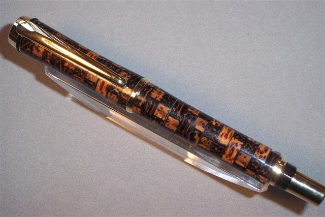

If you want a real challange do a sepmented black palm red palm glue up.
This is the one that beat me.
I eventually soaked it in a pickle jar of acetone

awsome!![:)]

I don't think I'm up to that skill level for a segmented pen. It's beautiful, but my wife already considers me crazy.
