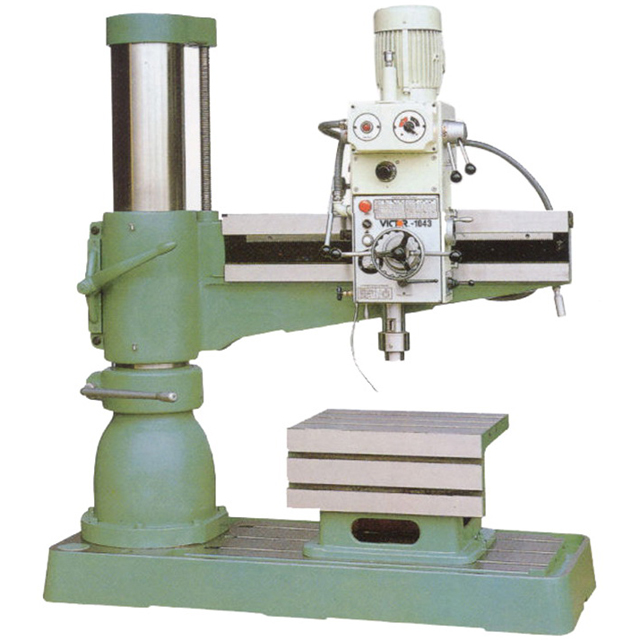

Pardon me, Mr. Skiprat. What the heck is a radial drill press?
Dave, who the heck are you calling Mr...? :biggrin:
I'm on my Kindle and struggle to attach links..but it's a drill press where the head and table are highly adjustable. They have a very deep 'throat'
Maybe someone can post a pic..

Main thing to consider is they only have 5 speeds to drill with. designed with wood only in mind. Now a clever rodent can probably figure out a way to put a step pulley in the middle to get a greater speed range. The next consideration is if the parts are machined to close enough tolerances to maintain alignment when the radial adjustment is used and if the head returns to zero when used too. I to like the versatility but have always been wary of the rigidity and adjustment returns.

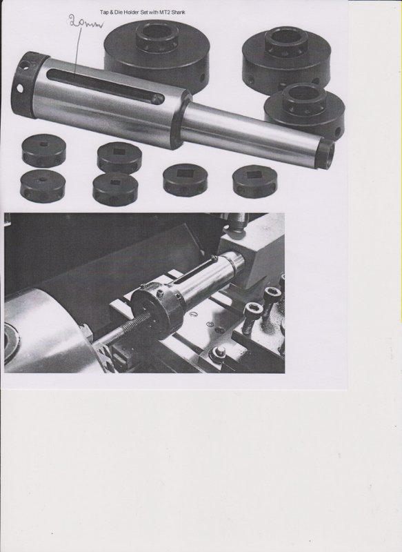

Nice to say hi again mate works for me attached find my new aquisition from E Bay for use on the lathe I regard as a step forward on the lathe tap and die holder.
Kind regards Peter.

Actually that is a true radial drill for metal. There was a similar one at work that some "wise" manager decided we didn't need and it was flogged cheap. They have morse taper quills and no provision for a drawbar so can't take side loads for milling. They have the power for drilling sizeable holes and have instant reverse for power tapping. skiprat, opps, Mr. skiprat would need to raise the roof on his shed to fit it in but the upside is being able to mount his lathe on the drill's table and always be ready to drill and tap into the pen barrel for a clip retaining screw. :)

Darrin the radial lets you tilt the head to drill angled holes along with moving in and out. Useful for drilling chair seats for the legs is one example. It is more use to most people for the furniture side of woodworking but in skiprats little paws the sky is the limit. They do come in floor models too.
