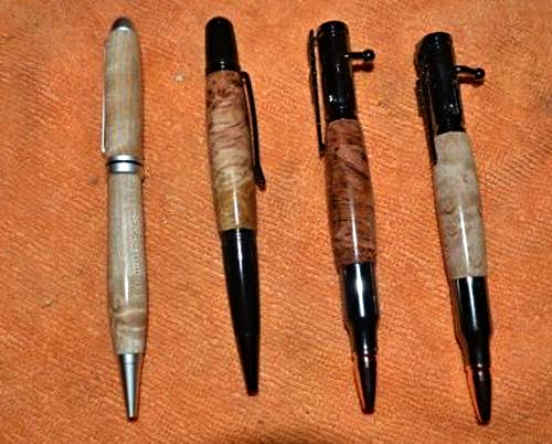

I showed a friend some of my first pens and he was amazed , especially with the cherry burl I harvested and stabilized . A few days later he asked me if I could make him a few , he'd buy them , I told him I'd be happy too . Here's what I ended up making for him
Euro pen , brushed satin - birdseye
Sierra , gun metal - cherry burl
Bolt Action , gun metal - cherry burl
Bolt Action , gun metal - birdseye
He attends a lot of regional conferences throughout the state as part of his work and said he'll show them around , so maybe this will help with the financing of my new addiction :)
Well Done Herb,
Excellent Pens, Great Blanks.
Superb Fit and Finish.
Good luck with some future Orders.
Congratulations,
Brian.
Thank you Brian . The day I started turning those barrels started off rather badly with some other issues going on , when that unpleasantness was over I told my wife I am going down to the shop , I turned them all one after the other and finished and assembled them . It was a great way to clear my mind and relax in my own way , pen therapy you might say :)
Well done !!!! . I especially like the cherry.
Thank you Mal . That was my last blank of stabilized cherry burl , I sliced up some more and have it sitting and drying a bit more before I stabilize it .

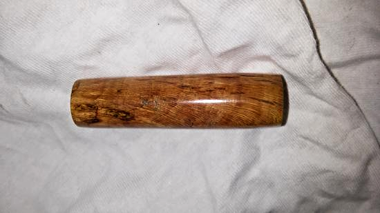

Well , my friend got his pens , he was thrilled with them :). I need to make 6 more cherry burl bolt actions for his associates , he said they sold without question . To say I am thrilled would be a colossal understatement ! Good thing I've got some more stabilized ,I have been stabilizing more cherry burl blanks the last few days . He also asked permission to give out my contact info to interested parties . Hopefully this will be the start of something .

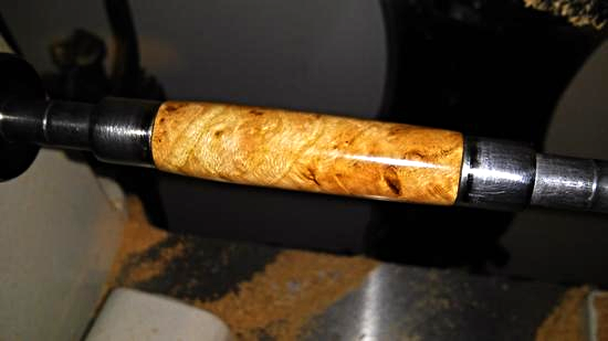

One barrel finished off the lathe , one finished on the lathe , I need to drill and glue up 4 more blanks and I'll get them turned tomorrow .

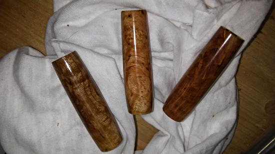

3 more Cherry Burl barrels turned and finished , had the 4th just about done and got a catch and blow out , tried fixing it but you can see the crack where it blew out so I'll have to glue up one more fresh blank

Your finish is perfect on these! Do I remember seeing that you use friction polish rather than CA?
Thanks Luke , yes , I do use Mylands Sanding Sealer followed by Mylands Friction Polish . I sand to 600 g and then use EEE on the barrels , then I clean them with naptha or DNA and micro mesh to 12000 , next they get a few coats of the sealer , followed by 6 or more coats of friction polish , final step is a good coat of carnuba wax . I'm no expert but this works good for me . Being in a basement shop I don't like using CA too much , the fumes are awful , I've done some finishing with CA but just prefer the sealer and friction polish . Some day that may change but for now that's my method .
