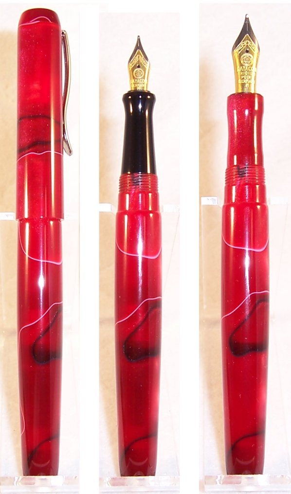

Trying a different look in regards to how the threads blend in with the lower body.
Suggestions or comments?

OUTSTANDING! I've really got to learn how you guys do those, they're just so cool looking, and the possibilities are so endless! I REALLY like the almost monochromatic effect. it's got just the right amount of accent color, and a really pleasing shape. Did you make it postable?

George looks great. One question, the threads look very close to the grip section. Do you feel them while gripping the pen? The clip looks great also. How about a picture closed and posted? please.:D

Very nice. On a blank like that, you might think about painting inside the blank black because of the way the inner section changes the color of the outer section. Or, although I hate to say it, make the section black. The color change draws from the rest of the pen. However, I think you have the threads down perfect.
If you want to "build up" the threads at the body, design that step to seat on the pen cap. This way there will be an illusion that the cap is thinner than it lip suggests.
Larry, the threads are in the same position as they normally would be, I just created a space between them and the lower body in hopes of breaking up the sharp transition between body and threads. I don't feel the threads when writing. Actually this grip jacket is slightly longer than the stock Berea jacket.
The cap is still a bit long, I am waiting on some silver so I can make an accent ring then I'll shorten it a bit.
Lee, I hear you and if I use any real light blanks will have to coat the inside of the grip but in real life this grip doesn't look much darker than most of the blank. This is one of those cranberry swirls and the flash makes it look lighter than what it is. There are darker red places on the body than the grip.

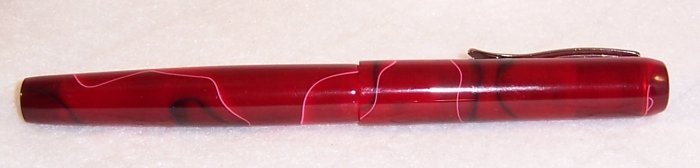

Here is the pen closed. The cap is step drilled so it comes down over the lower threads.

The workmanship is first rate, but being able to see the piece of tube inside the cap doesn't thrill me much. I think for something like this you need a completely opaque material.
There is no tube in the cap, just plastic. I think I see what you are referring to though. I switched drill bit diameters in the cap and the top 3/4" has a thicker wall which shows up darker. When I get my designs down pat I plan on using dark acrylics and ebonite. Right now I'm practicing on my least favorite acrylic blanks.:)
This is good to remember though in case I ever want to make a pen from very light or translucent material and need to coat the inside with something.
Thanks, I wasn't even watching for that, I might experiment with coloring the inside of this one.

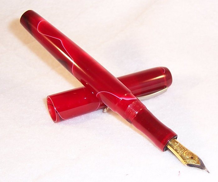

Originally posted by rhahnfl
I like the fancy nib on this one!!!
Well I did at first then I didn't! I wanted the slightly inward curving line of the pen body to flow into the nib holder better so I made another one. And while I was at it, I decided that there was enough black in the body that a solid black nib holder would look nice. Below is the same pen but with the new black nib holder next to a photo of the first red nib holder. I also shortened the cap by .350".
So what say you, did it get better or worse?

I like the new nib holder better. I think the shape of the new nib holder is much more refined than the red one. Either color would work in my opinion with the new shape.

Originally posted by Chuck Key
Did you use the same nib or a smaller one?
John, I used the small feed holder that Craft Supply sells. The ones with the teeny tiny threads, but with a letter "I" bit, you get a nice snug fit that a drop of CA bonds nicely.

I like that one much better. "I" is one of the three bits I have been using with this feed. I remember them by using "BIG" for the three bits. :)

I like the black nib's shape and length a bit better,
but I don't like the strong blank contrast.
