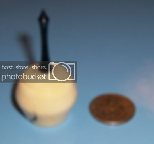

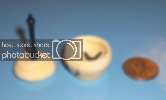

So I've had these jumbo tagua nuts at the house, not sure what to do with them. I wanted to try the carving, but I lack the couple hundred bucks for the air grinder. So, I turned out an other little box from one. Nothing special, there's tool marks on the ebony finial, there's CA bubbles in the black fill, walls are thicker than I'd like, it's not as deep as it should be. But, it gave me something to do and a starting point for little boxes. If you've got any cut offs and some time to burn, they're pretty fun!

lookin good, skye. I appreciate your honesty about the quality of your work and the flaws we cannot see.
I enjoy little useless items like this more than big projects sometimes. May I comment that the finial makes it look a little like a spinning top? I would think either make it shorter or more elaborate/delicate if you want to keep the height.

Brandon, for me that was elaborate, lol! I've never made a finial on anything, never mind something so small. I have a new appreciation for birdhouses and Christmas ornaments now! I'll probably go for something more intricate next time though.

Yeah, that helps a lot. If nothing else (for miniatures) you can use a face plate and a small waste block. I just glue my nuts to the waste block.

The hard part is getting a flat surface to glue to. I don't have a bandsaw so I held one nut in my plastic saw box and went to town.
Now, I don't know if you've ever had one of your nuts in a miter box, but it's not an easy thing to do. It keeps wanting to roll around and bind up the box saw (which isnt exactly a piece of surgical equipment to begin with), so it took a while. Lots of sweat and gritting of teeth.
I slather CA on both the nut and the block, bring the tailstock in to squish the two together tightly, then shoot accelerator at the joint.
