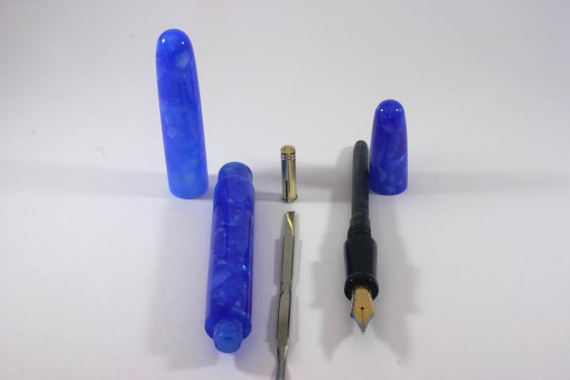

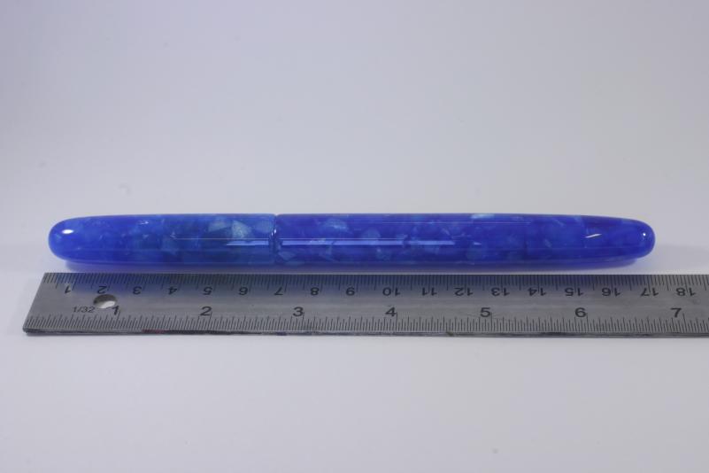

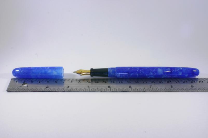

This is a commission order for a chap who specified the material, filling mechanism and the size. This must be the biggest pen I've made so far.
The section is black acrylic, as the customer may want his Pelikan M800 nib put in the pen in which case it will be in the same material as the body.
My first button filler. Lots of measuring involved, but I enjoyed the whole process.
C&C's welcome.

I'm guessing that the metal pieces in the middle of the last picture are the button filler mechanism parts...

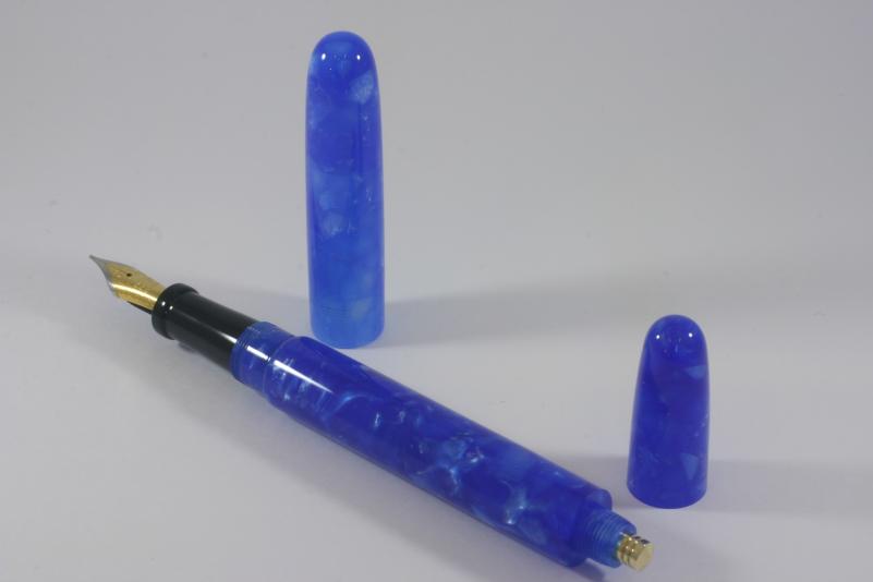

Interesting how far the cap threads are from the lip on the body. And that is a really long pen. But the customer is always right. What is the thread size you used for the end finial?

You're correct Chris. The button I made from brass, but the pressure bar is bought in.

Bob, the blind cap threads are M9x0.75. The button is 5.5mm.
