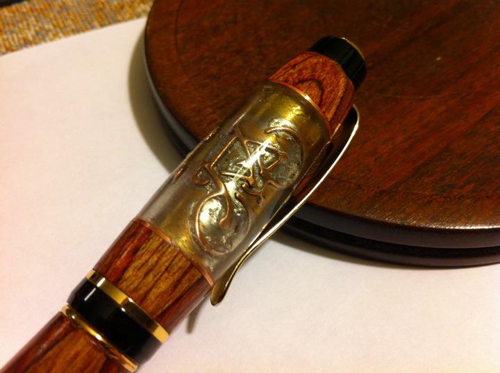

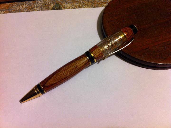

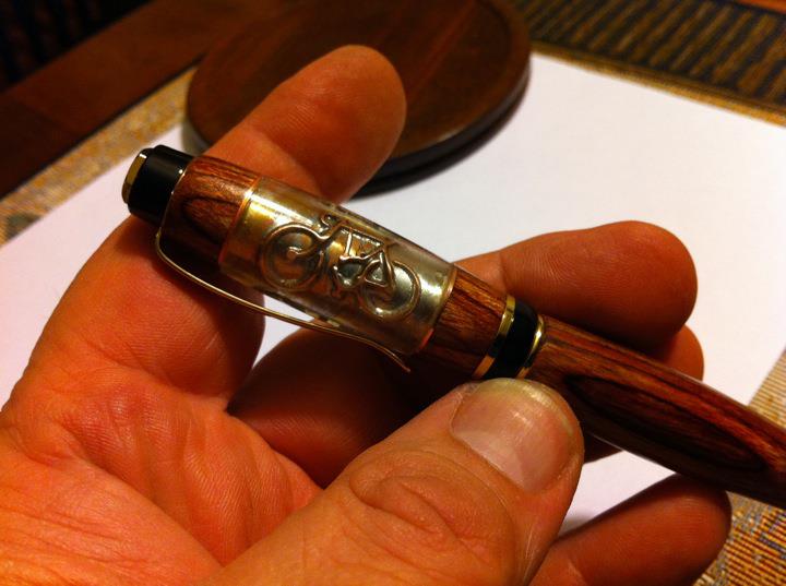

After rooting through the forums and seeing what you all have made, I got ideas... and ideas... and more ideas. So, technically, there is a little of all of you guys in this pen. If you see something you would have done different or you don't like, well that part is not yours.. I'll own it... but mostly this was inspired buy a new friend that I have a lot of respect for (even though she is a bike Nazi) so I think I'll name the pen "Rhonda's Ride".

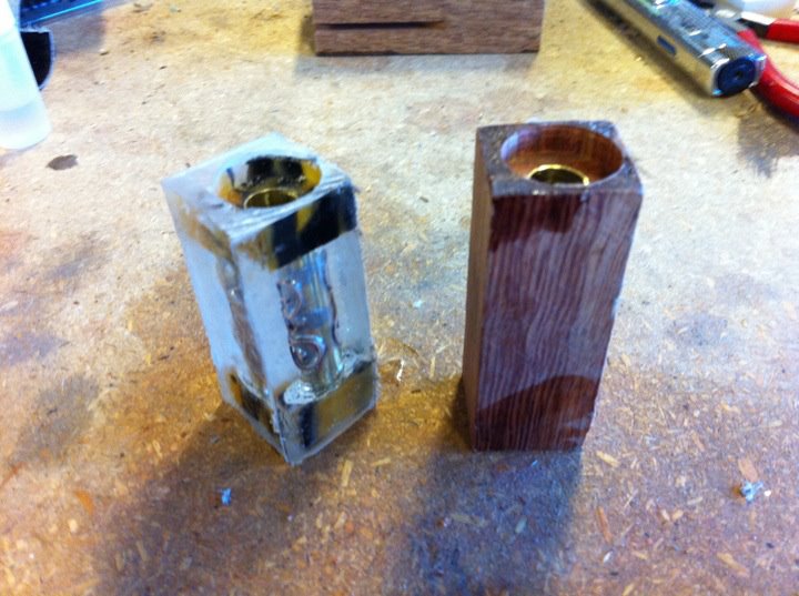

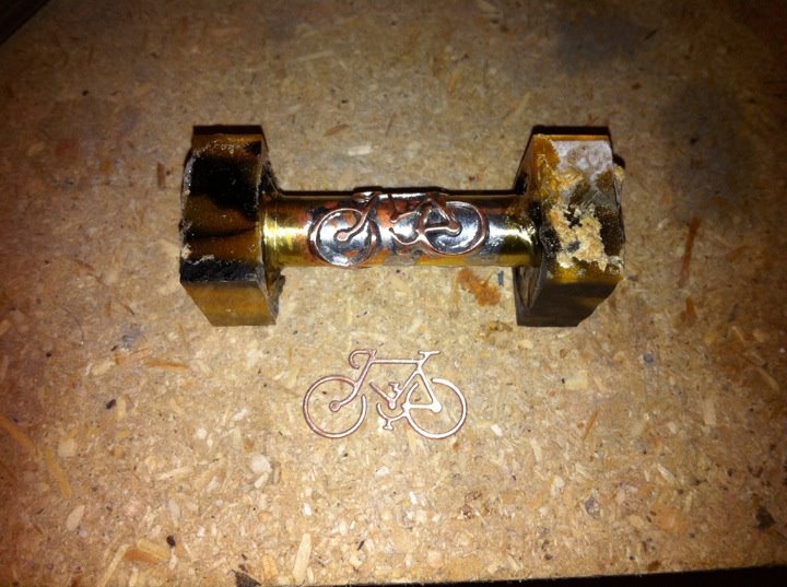

I decided to cut out a small bicycle on the waterjet at work. I wanted to see how small I could get it. After seeing a pen with solder on it, I thought it would be a great idea to cut a bike out of copper and solder it to the brass pen tube... then cast in in resin but wrap the lower tube with wood.
Please see my photos.. and video of the waterjet cutting bikes at the following like (if all works the way I think it should):
http://www.facebook.com/v/2415378866058
Thanks for looking.

Nice idea,
I would use a thicker piece of copper and cut it on the water-jet just like you did. Now bend it so it would conform to the tube shape and glue or silver solder it into place. Cast a solid color to just below the hight/thickness of the copper then cast the rest in clear.

Constant Laubscher said:
Nice idea,
I originally wanted the solder and brass tube to show for a mild steam punk (industrial) look. I figured it would pop with the birch ply. You idea intrigues me and may be the focus of "Rhonda's Ride II". If I use this wood, I'd have to make the color black.

Tim -- I like it! Great concept, and great execution. Many possibilities with this method. Nice to have the extra toys to be able to do this!
If you're looking for a variation other than the industrial look, you could consider an alternative to Constant's suggestion by painting it black after soldering, and sand the surface to highlight/polish the copper bike to keep the 3D relief visible after casting in clear.

Some people have all the cool toys. Just out of curiosity what is the water pressure on that thing and how often do the nozzles need to be changes? Won't be many copying that one, at least not made the same way.

I'm actually on my way to the next one... I will be cutting the Harley Davidson logo (thicker as suggested) and casting it in black resin. I have made a "Die" out of tool steel which I will use to drop the logo in, and press it to shape. Early tests show that I need to cover the part in tape to prevent it from distorting while shaping. I think I need to polish the pressing part to allow for slippage while it forms the part.
I plan on casting the tube in black resin then turning it down to the point of seeing the logo. I'll polish it so the copper shows nice and shiny. Afterwards, I'll hit it with acetone to make it sticky so that I can cast it in clear. After clear, I plan on a band at the top and bottom of Harley orange--separated by copper again. The lower tube I plan on turning it tighter than normal (make it skinny) and wrapping it with leather. I will put a stitch right up the side as to look like stitching on the saddle.
Photos to follow.... Someone PLEASE beat me to this.... I told you what and how, now show me where you can do better.... we'll compare notes.
Because I was cutting the part so small, I started with 10,000 psi... shooting water through a .005 orifice with a .020 mixing tube. The abrasive I was using is a 220 mesh garnet. To get the cut I wanted, I ended up cutting at 30,000 psi.... the machine is capable of 94,000 peak pressure.
