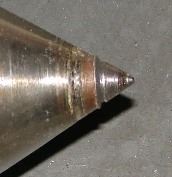

A word of caution when setting up to do 'no mandrel' turning or when you buy a live center for use with your mandrel. Get a top quality live center that is made with hardened steel. The one shown below cost about $5.00 and I gave no thought to wether or not it was hardened when i bought it. It has been in use about a year and used considerably. So, I guess I can't complain about getting my money's worth. But, I do like things to last and remain accurate. This one no longer is accurate. Spend the extra and buy quality. Some even have carbide tips. Check out machinists supplies for a larger selection than in the woodturning catalogs.

Point well taken Hank. I did forget to mention that I only use the mandrel to get it CLOSE. I then remove the bushings and put it on one of my homemade Delrin dead centers in my Beall and sand it down to .003 under the kit hardware, which I measure with calipers. I leave it on for finishing also. SO, technically I guess I AM turning between centers, just not with custom bushings. Ya' gotta stick with me, the truth will come out, SOONER OR LATER!:D:D
