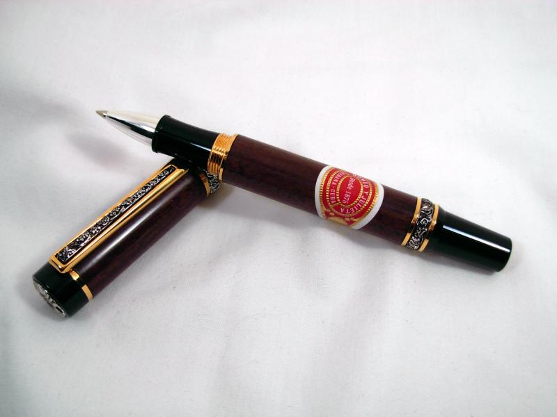

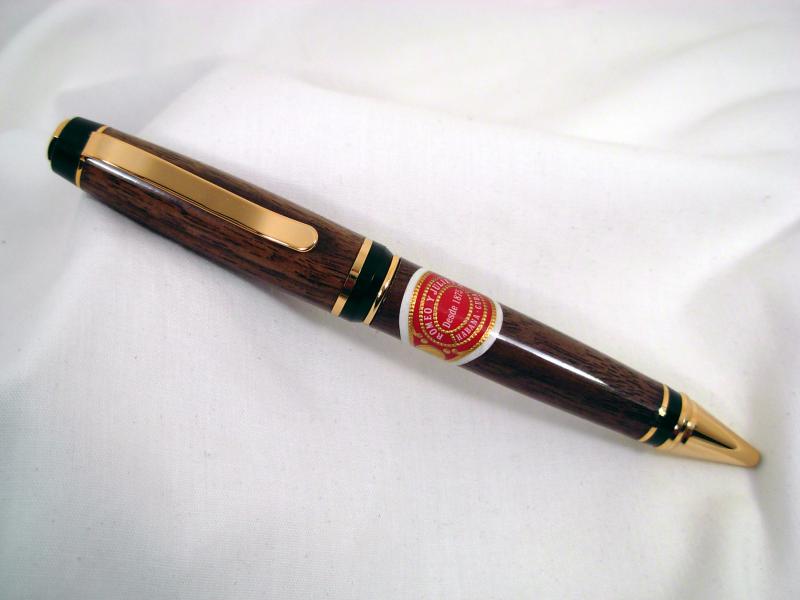

I've had my best luck using a Claro Walnut. I've attached a couple of pic's. First one is a Churchill rollerball, the second is a Cigar kit
