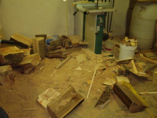

redfishsc, I use my 17" grizzly bandsaw a lot. One thing to think about is the ability to resaw you own blanks from reclaimed or othewise found wood. I saw 100's or 1000's of blanks from all kinds of wood and it is important to be able to maximise both figure and color in the blanks. I find it fairly easy to cut square blanks on the bandsaw and you have less kerf in the process.
Here's an example of the aftermath of resawing bowl blanks
